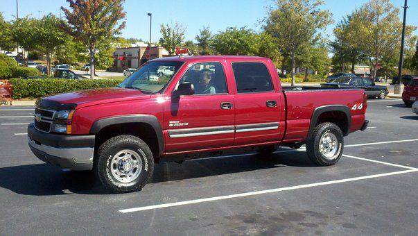

Truck: 06 LBZ Duramax LT

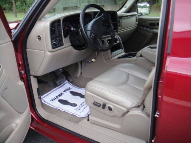

Here a re some pictures of my install. Note the USB port I installed.
