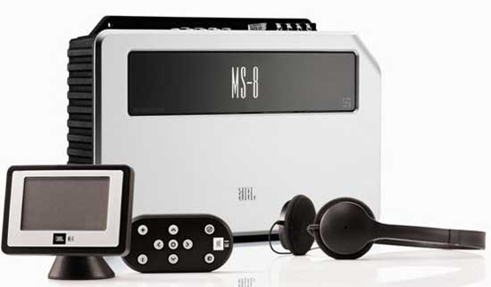

Ms8. Has a aux input. can power speakers with it and can be totally hidden.
