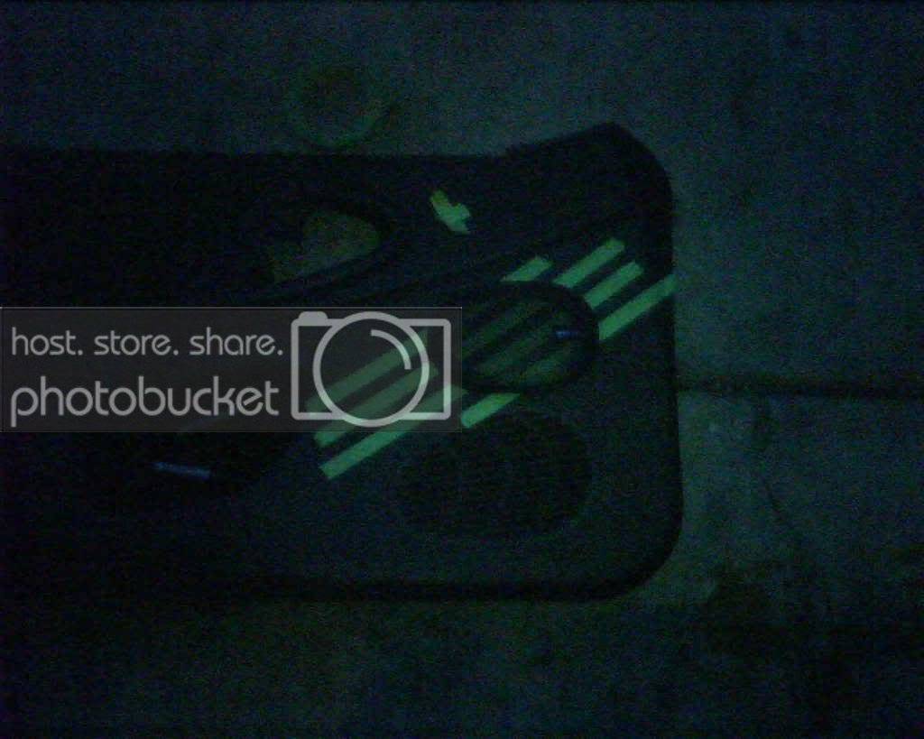

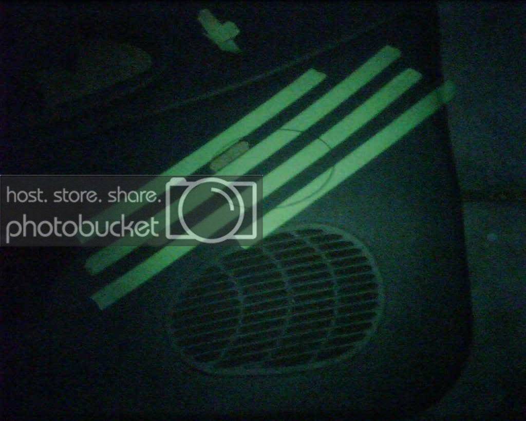

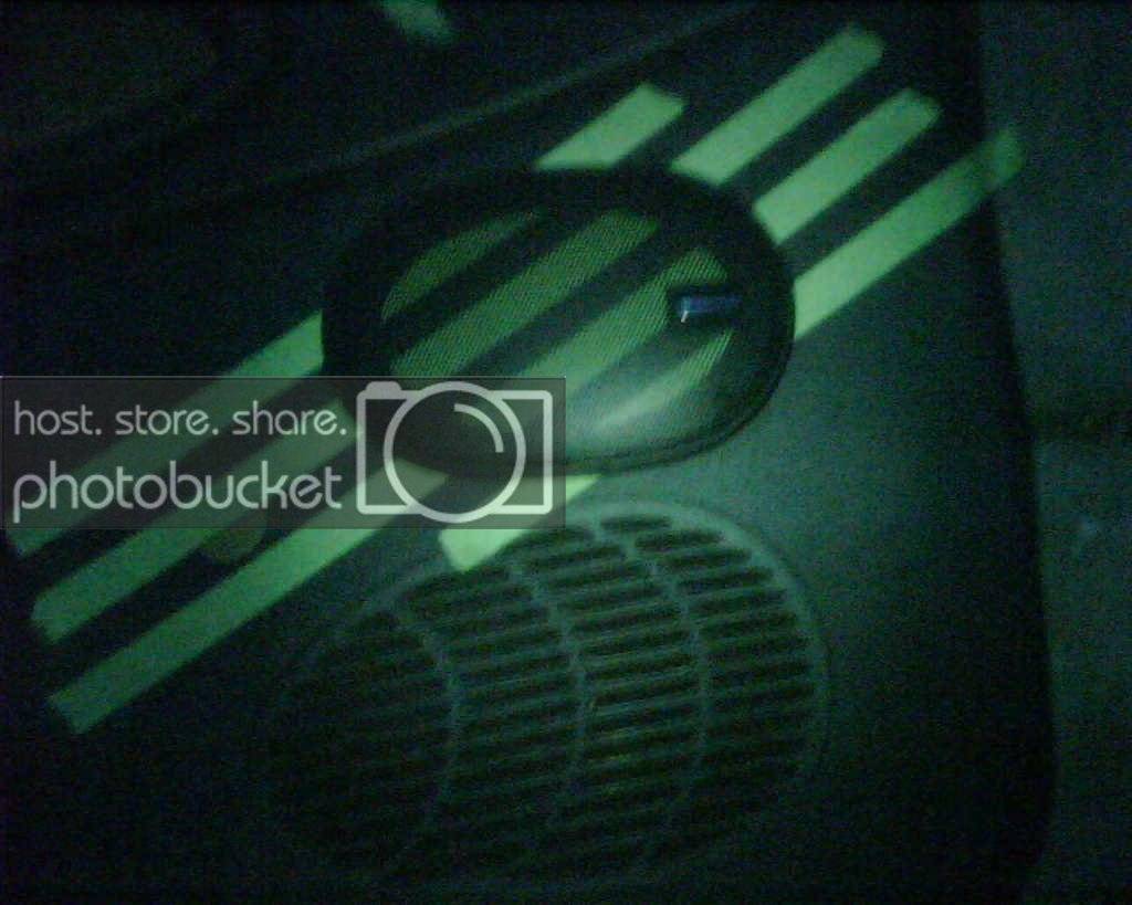

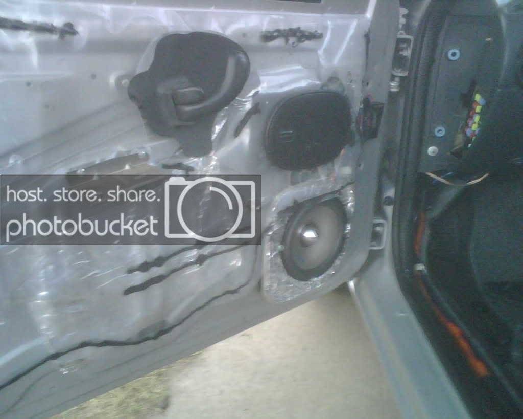

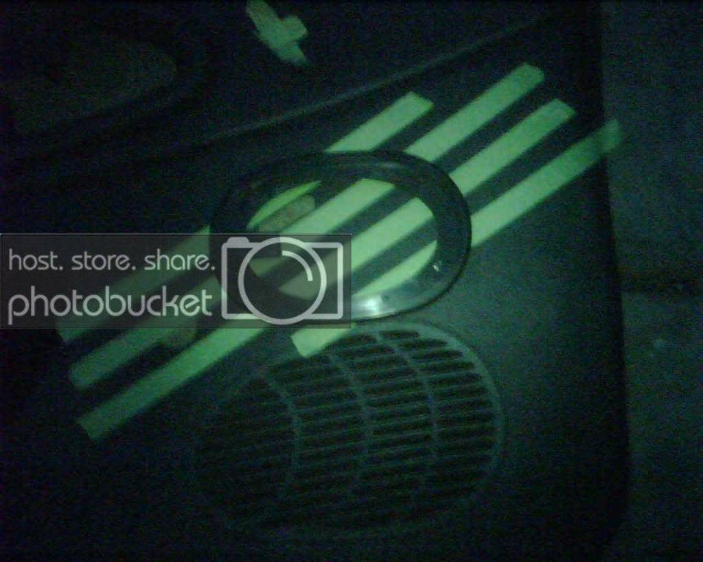

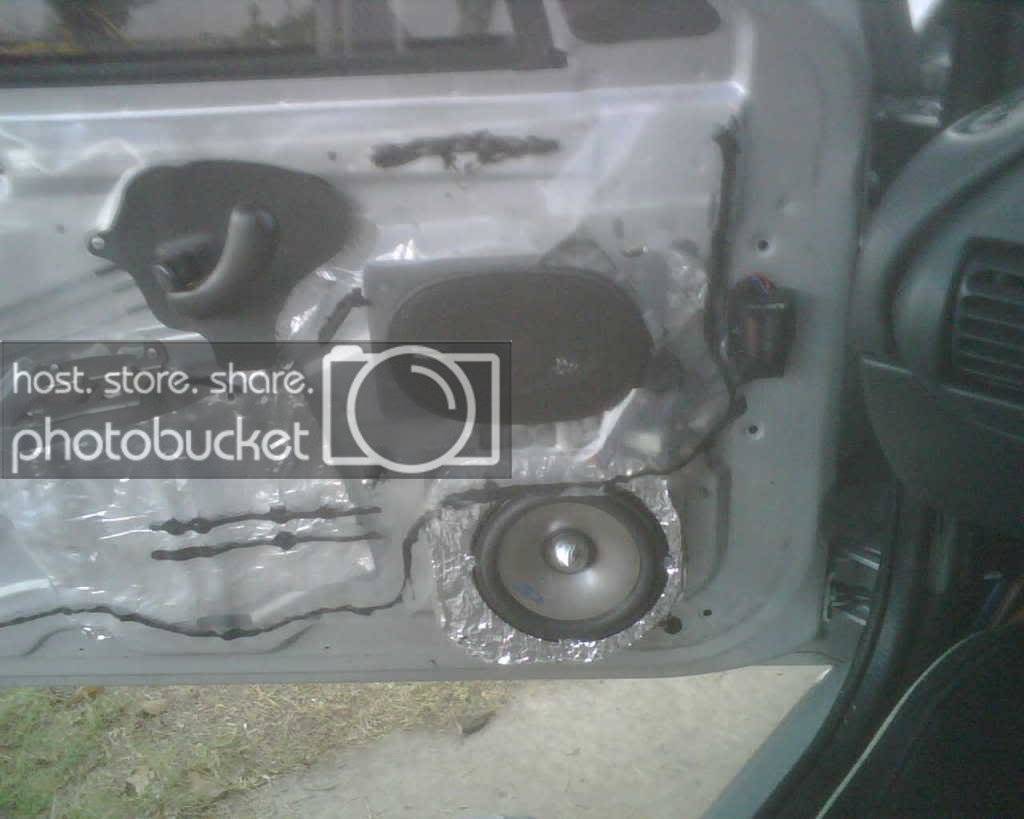

Well, I put a type S alpine 6 1/2 componet in there for now and moved the 4x6 up. I am cuting a grill pattern in the door panel and I will put black fabric behind it to give it that stock appearence.
