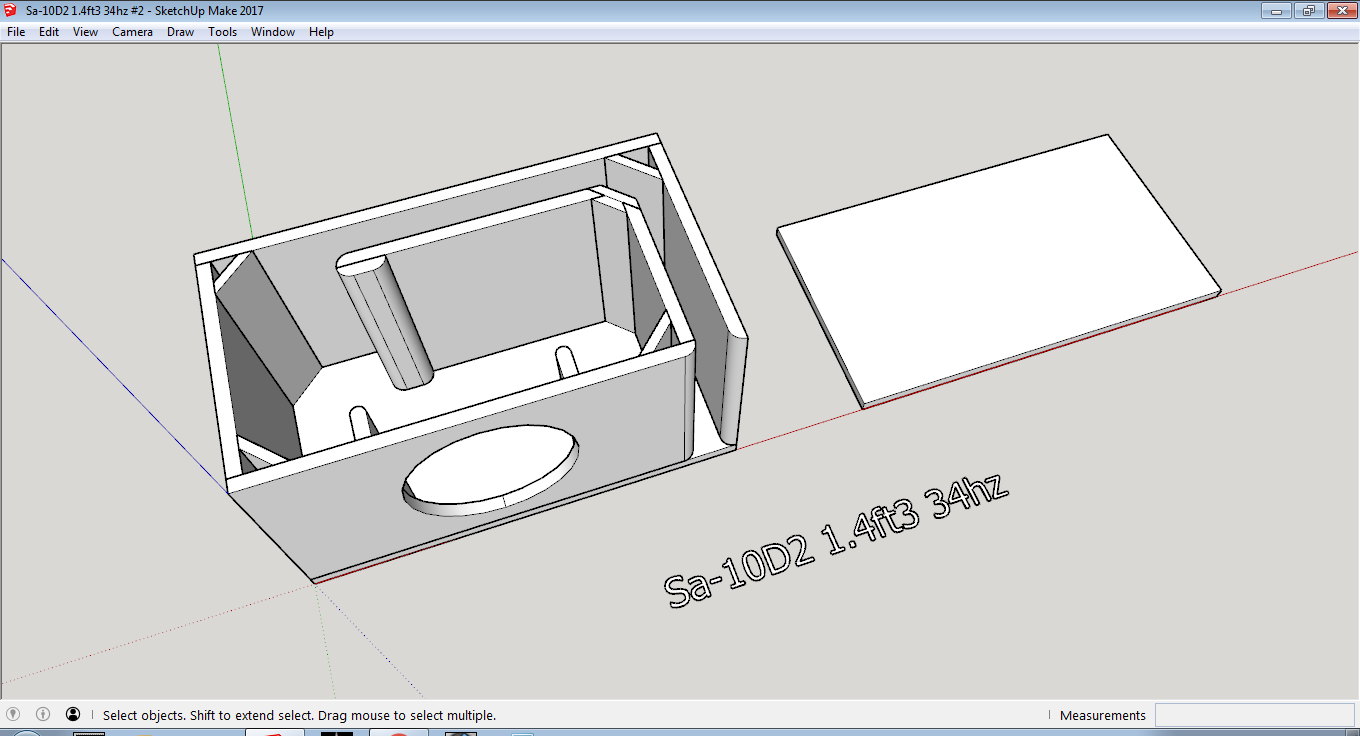

The question was is the sub/port up... did you answer yes? In that case you should really look a repositioning the box maybe even rebuilding the thing if it dont work well, I've seen big differences with the orientation in a trunk and firing into the trunk lid or deck requires a lot of deadening and luck... maybe something configured like this...
