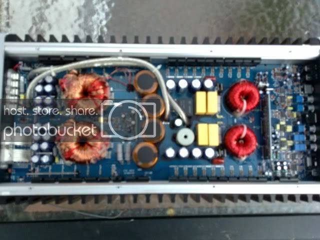

Does anybody have pics of these amps guts? I had a MB quart dsc1500 and it performed very well, did over 1600 RMS. Now I am looking to update my amp and these are the choices. I am wanting to see the internals because based on the components I can pick the better amp. Maxxsonics said that they will do around the same amount of power give or take. But I would really like to see the internal build of them. Also if anybody has experience with both chime in and let me know which you liked more.

and regardless of any of that... the dsc while under rated...are not near as tough or well built or as efficient as the newer BRZ line is...look really close at that gutshot i posted then go look at a DSC 2k gutshot...look close...really close...dang them boards sure do look exactly the same....quite a bit more in the BRZ tho... new more efficient HS design less weight... over all better built and notice the DSC line is now gone? replaced by the formula and onx lines? hmmm... wonder why that was...

i didn't open that amp the customer did he didn't care about the warranty and is running at .66 daily anyway... lots of guys on ROE are running daily at .5 on the BRZ with 0 issues as well...
Isnt that pic of the 2400's guts? And I talked to Mike at Maxxsonics and he said that they would both do 1700 and change. actually he said the 1500 would do a little more power but the 1700 was more durable.
so are those guts a 2400 or 1700? because I was looking at the brz2400 and got the same pic of the guts. If that is the 1700 I think I will spend the extra money to get that opposed to the mb quart, although the mb quart and hifonics do rated and more the pic of that amp looks more like a 2kw than a 1700. you wouldn't happen to have internal pics of the q1.1500 would you.
