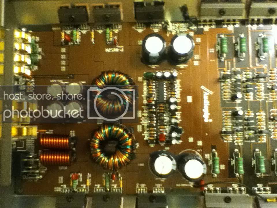

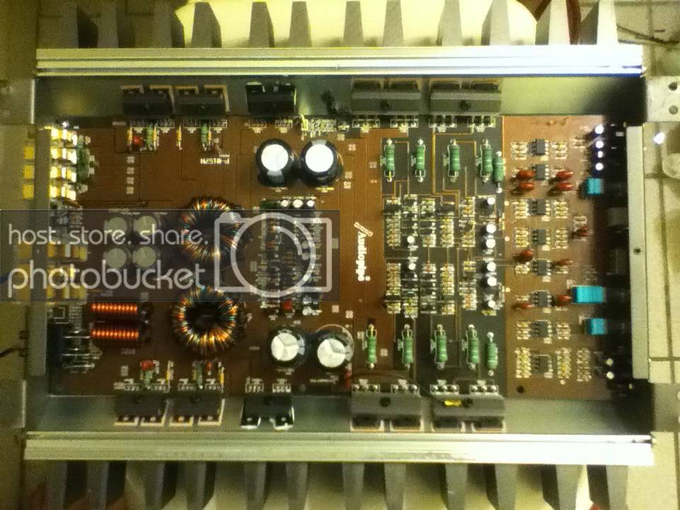

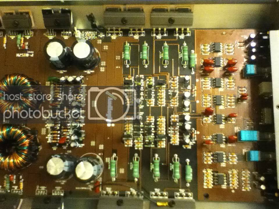

this is gut shots of a Audiopipe GM-1502. rated to do 150x2 or 450x1. Well it's been sitting around for a long *** time and i figured i would play around with it. Turns out this is a very well built amplifier , sounds amazing and upon inspection of the IRF brand fets (IRFZ44's in the PSU , and tip35c/tip36c in the output section) i bet it does every bit of its rated power. I don't have the equipment to bench a amp but i listened to this on my doors today and it is definetly my top choice out of the 4 available amps i had to use on my doors. (bostwick MA-250zx , orion cobalt 260 , pioneer gm-5300T) this amp really impressed me , i still don't believe its a audiopipe amp. LOL
nope. its actually very well built and packed with high quality parts. notice how if you draw an invisible line through the center it looks like a mirror image? thats because the entire left channel amp and right channel amp are completely seperate from each other. Not a bad amp at all. Here is a vid of it pushing one of my doors (the other door wasn't finished yet , LOL) 5fe93423.mp4 video by stanky1219 - Photobucket

Most Chinese/Korean amps are very pretty inside. They look very neat and tidy yet some of the locations of the componentry doesn't make any sense except if the board design put a priority on how it looked.
Your remarks on how the left and right channels are separate isn't anything new or special. It's an old Fosgate design and I'd imagine 9 out of 10 Class A/B amps on the market today are based on that original 1970's Fosgate design. What's surprising is that it has a regulated power supply. Those usually cost a bit more than their cheaper unregulated brethren. However that's not to say an unregulated amp is cheap...the good ones cost quite a bit more than regulated amps.
Everything looks kinda standard...which isn't a bad thing. It's not at all uncommon to see daughter boards used extensively to get the foot print of the amp as small as possible. That can be a bad thing as that's done at the expense of surface area...seems like your amp has plenty of that.
