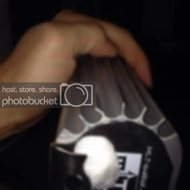

One of the feet that caught some of packaging (what was left after gape they caused) and bent fin:

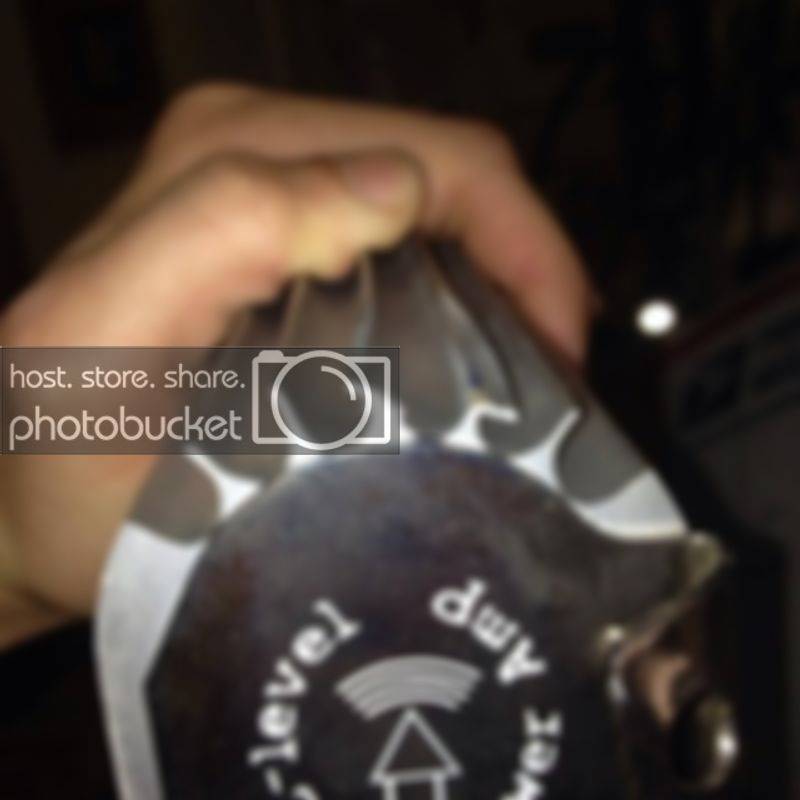

More bent fins and feet:
Plexi back:
