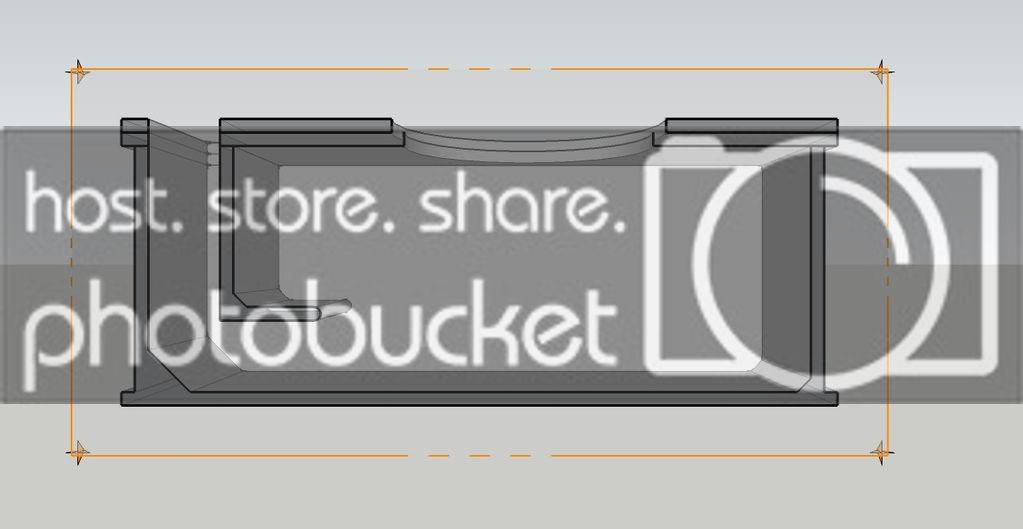

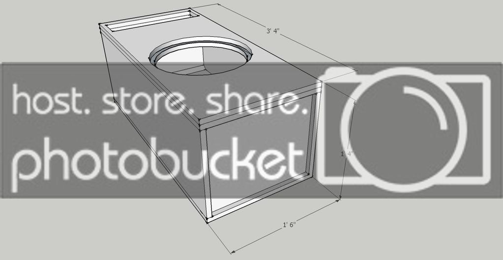

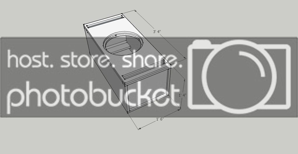

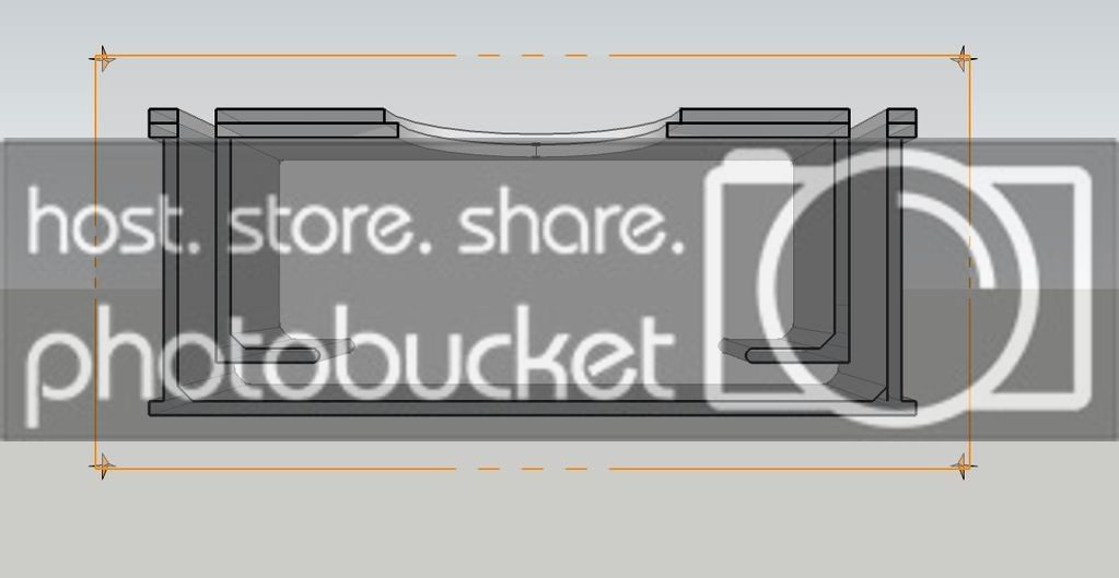

15.75x13.75x30.5=6605.15265
6605.15265=3.82
3.82-.3=3.52cu/ft
17" port = 38htz
interesting boxes. i have to go to school but sam later on would u mind doing some trial and error with me to pick the best box for me? nice work //content.invisioncic.com/y282845/emoticons/smile.gif.1ebc41e1811405b213edfc4622c41e27.gif
Hey, your PM box is full so I'll post this here but I see you have a design, I can build the box for you. Price will be $175 shipped and that includes all materials including your 3 -4" areo ports. My boxes come with a 3 month warranty. PM me for details
You should be using more like 5 4" Aeros. Each 4" Aero port will give you a little over 12 sq " of port area, when the HDC is suggested to have 16 sq " of port area for every net cu ft.
Now using your measurements..........Total air volume before all displacement is 4.56 cubic feet. Unless you are willing to go larger on your measuremens on the box. You will not be able to get what you are looking for.
