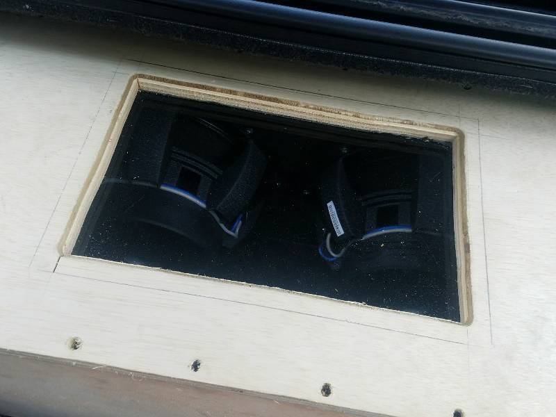

This is mounted with magnet in vented side... sub mounted from sealed side with removeable panel. It's only 1.18ft3 sealed or so but that's what it took to keep excursion under control in Winisd. Lotta port too, I was lookin' for peakiness and efficiency between 40-60hz... seems like I got a little more low end than I expected. I'm pleased with the result for a single 750 watt 15" sub.

looks great.. they say fu does well in 4th order.. if it tuned at 48hz and plays down to high 20's how high would it play?, aren't the freqs they play more narrow than reg ported?
It's all about the sealed to ported ratio. The ratio, the volumes of each chamber and the port tune of the ported side create the shape of the pass band or the width and ripple of the response curve.

The 4th order has a slow roll off like a sealed box. Cabin gain helps out big time as well. BBP does a decent job of predicting it and you can pick where the 12db/oct kicks in, I can't go back to Winisd because it's no where near close on anything below 50hz because it can't add cabin/room gain.
