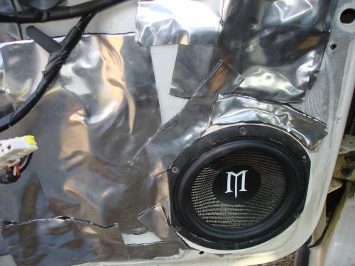

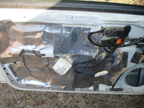

Excessive Amperage HO alt, 3X dekka batteries in back (may add more or even pull one depending how many amps I use and how much I decide to compete...and in what class). I have done some deadening, mostly in the doors, but some on the lift gate (Damplifier SPL tiles IIRC) Also should have the new Zed Ra (bass restoration/pre-amp) in the next couple days.

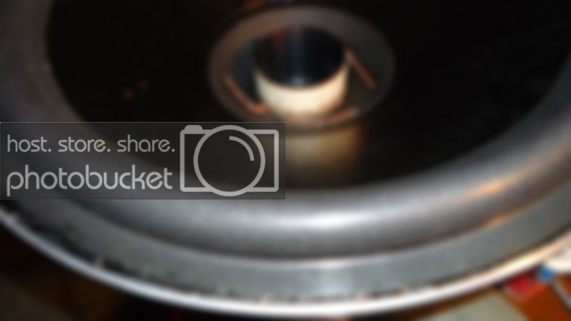

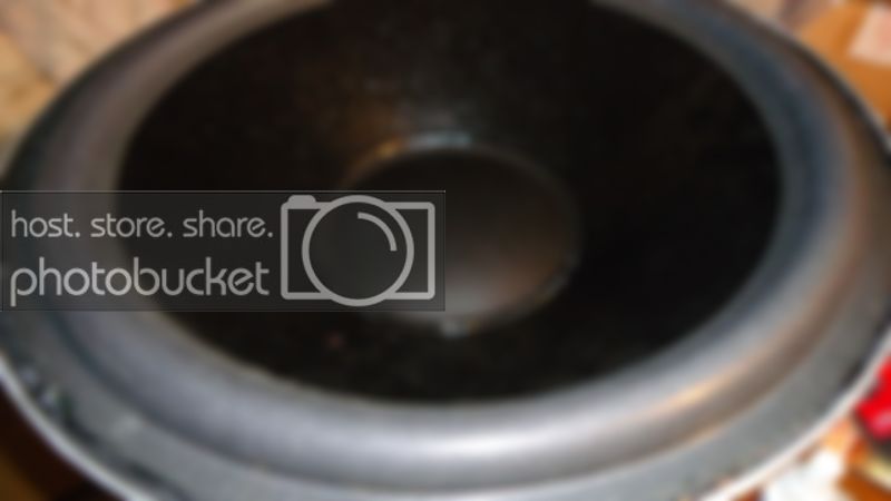

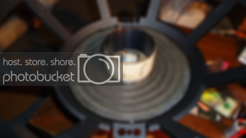

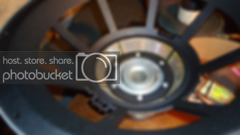

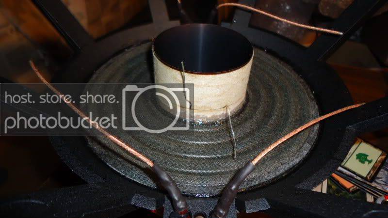

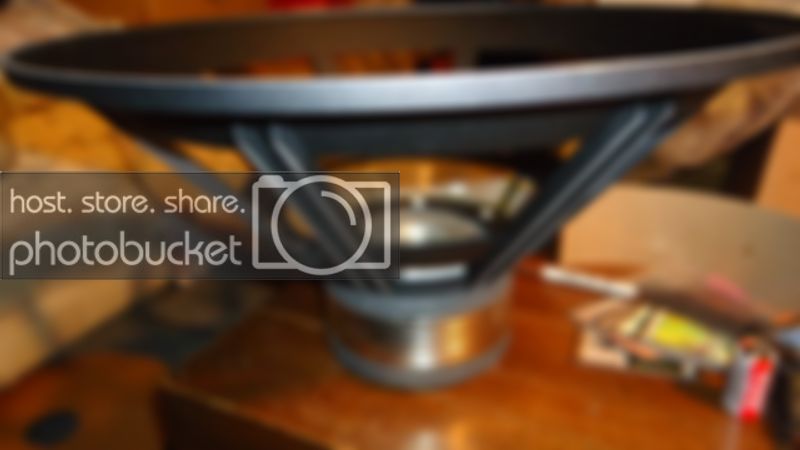

I had these Neo motors built up as 15" and smoked one while testing the new amp. Since Shocker Mike is out of 15" cones in the style I want I went ahead and ordered some stuff to do them up as 18's.

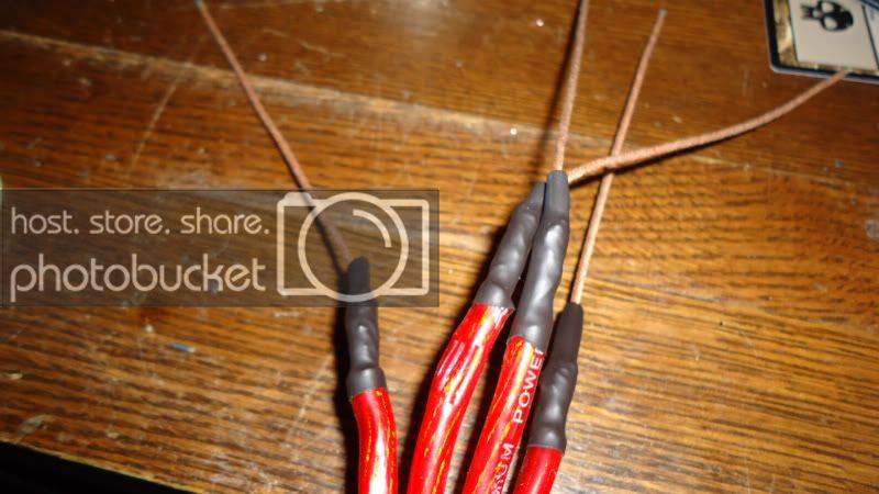

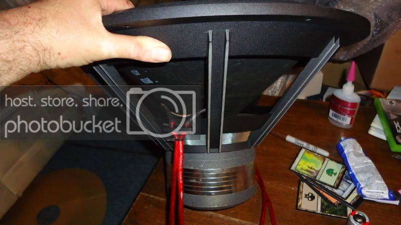

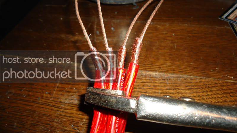

Trying a little something different with these direct leads.... Yeah I know all the wire is red....it was "deal of the day" at audiosavings and they didn't have black for that price..... I'll mark one with a piece of tape.
what can those subs take as far as power?
they look unassuming, but those neo motors are retarded strong

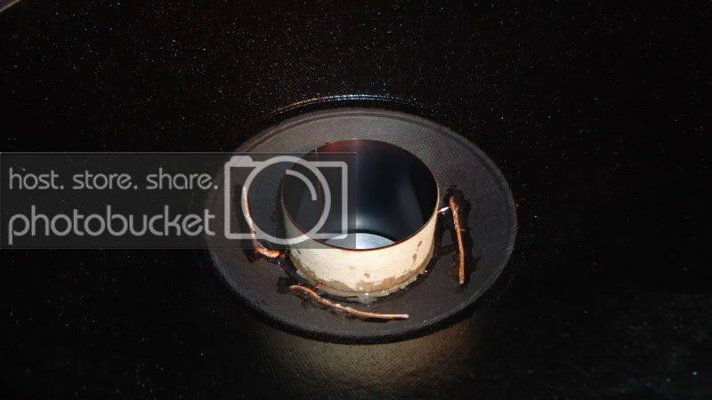

Coils are good quality. Realistically I think the pair would take a single 4K daily without too much worry and shoul burp with the pair no problem. These copper coils I'm using should be a bit more forgiving as well as far as expansion/rubbing (very tight gap in these).
They look goofy, but the neo gains about a full db over the nearly 80 pound ceramic sig motor. The idea is I really won't need to throw abusive ammount of power into them to get painfully loud.

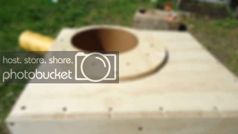

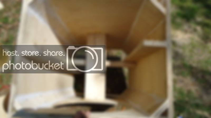

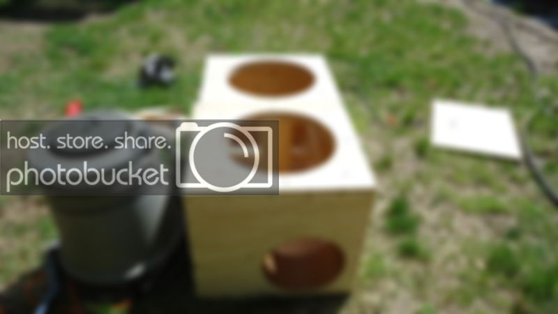

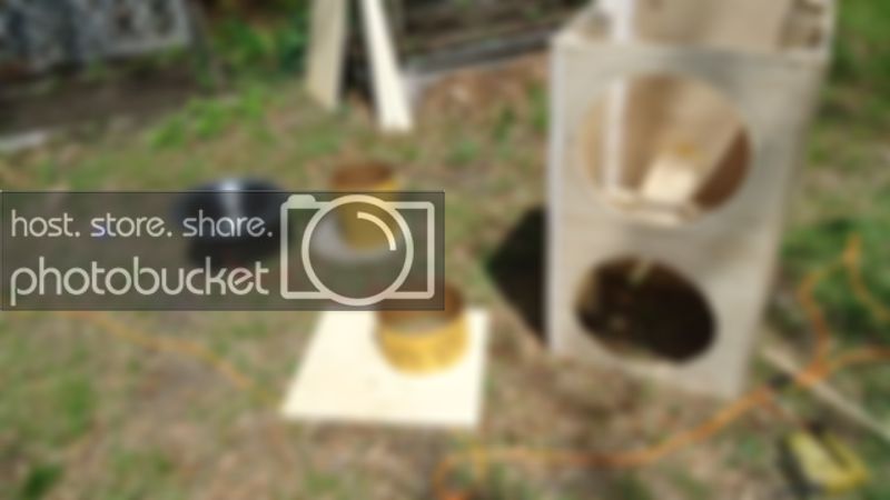

Slapping together a box. Using multiple ports. The 12" port should tune around 48hz for burps and the 10" insert tunes high 30's for daily. I wanted to port up the top but I can't do it around the bracing, and the other side of the Jeep doesn't have as much clearence in front of it. Changing ports should be relatively easy with a second guy to lift the box and tilt it out.
More bracing. I use scraps of whatever I have laying around to brace tyipcally.
I used 2 pieces for the doubled up baffle with just a thin bead of caulk to seal. Ideally I can switch up to a single sub with an intact piece over one hole, or switch one or both sides out for different size woofer. Could even turn one into a port, plug the side port and use a single woofer.....Just more options for playing later.

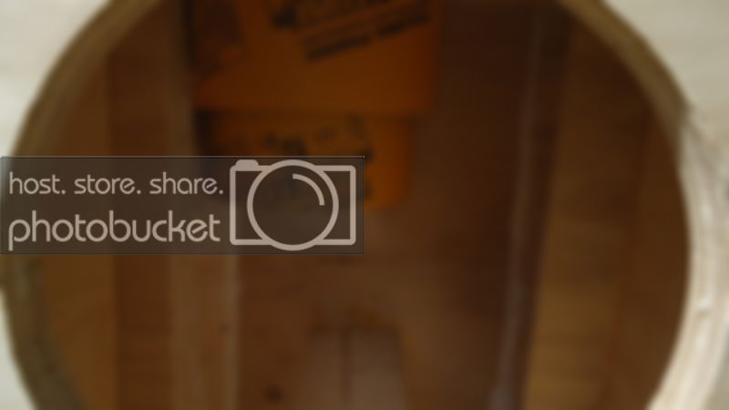

Pics of the 10" port inserted.
