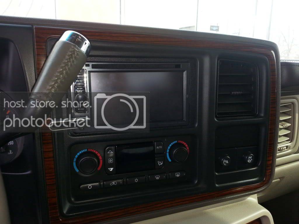

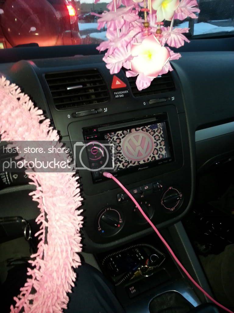

I've had alpine head units in the past, they have always been great to me. I have had 2 pioneers, one cheapo single din for a beater car, which was aright for that application, but nothing more. I currently have a double din touch screen pioneer ( forget the model number ) in my girlfriends 08 jetta with stock speakers and a set of 12's and it has a great eq on it, no complaints except the operation of the menus is a bit clumbsy. I have a Kenwood DDX-419 ( I think thats the name of it ) double din touch screen dvd unit in my escalade that I LOVE. Has kick *** sound, great menus, bluetooth, pandora, 3 sets of pre outs, video in and out, everything I need, and I got it under 300 bucks ( opened item at bestbuy ) My buddy has a kenwood single din he bought for under a hundred bucks that has everything in the world in it as far as LPF HPF EQ and what not, and 3 sets of pre outs.
In closing I feel that Kenwood units have the best bang for the buck right now, just from my own personal experience, not a million reviews read online.
Heres a photo of mine.
