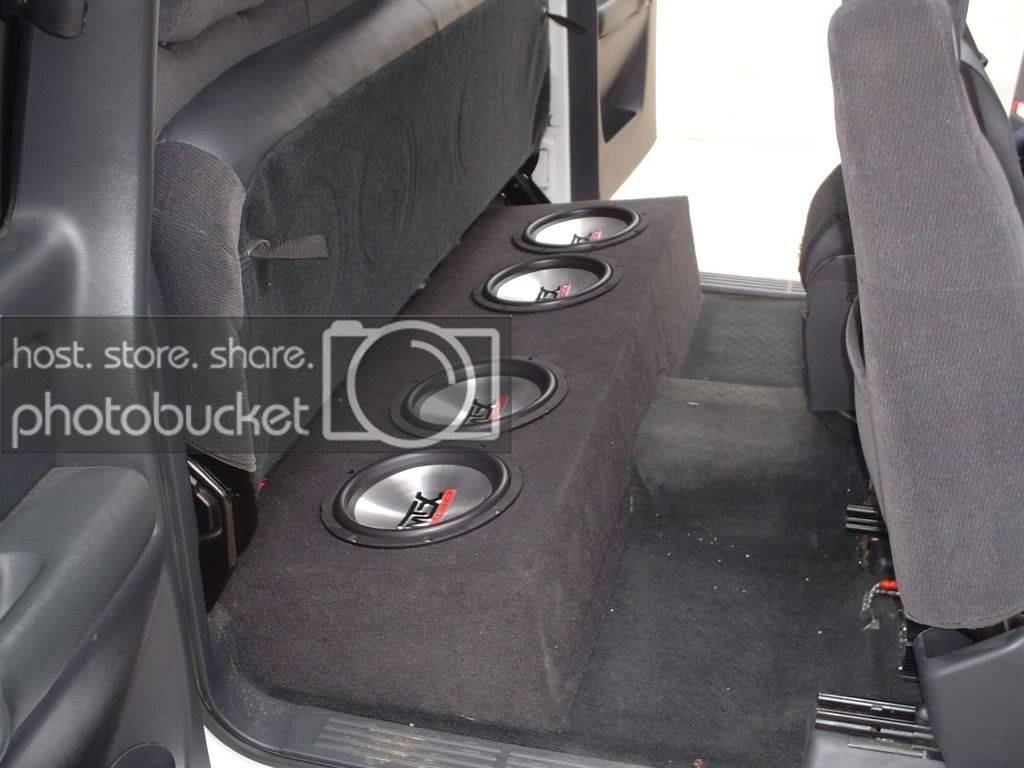

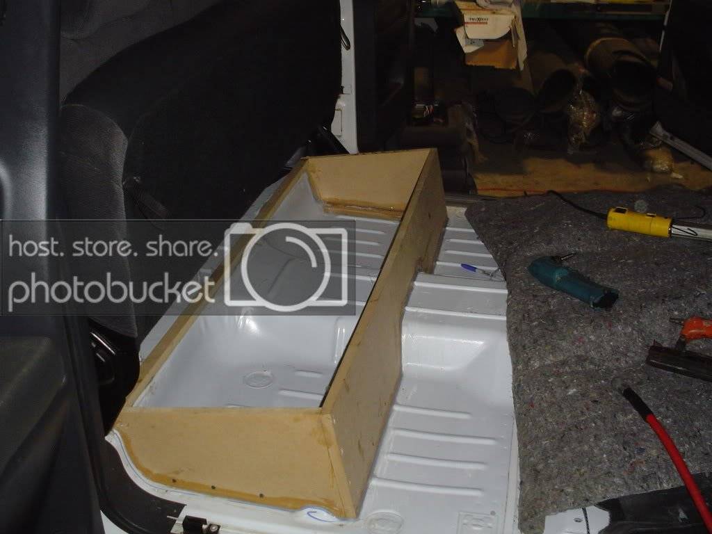

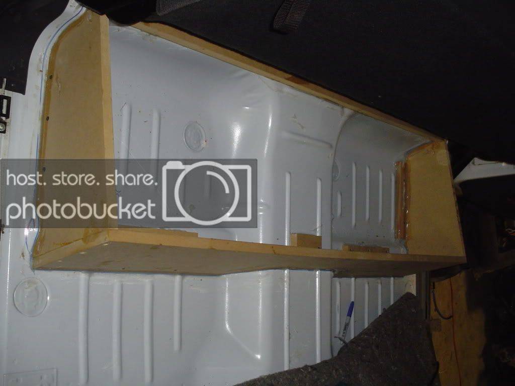

I was working on a box for my buddies 05 extended cab silverado, not sure if you had found that old thread. Of course he would never listen to me but listened to one of the shop guys around here and I think is finally going to drop the idea of 4 12's under the back seat in an up/down firing config. However this is all after we had made the box.
Definitely look into raising the seat about 2", this should give you the room you need and not put anyone near 6' tall up into the ceiling. Its been a long time since I worked on that box or measured his truck but I think with a 2" lift you should be able to mount 12's facing foward, this will allow you to fit a good sub (higher mounting depth) Otherwise if you choose a sub(s) that has a more shallow mounting depth I would go with a downfiring configuration.
You have probably already checked it out but there are a few pics in this thread here... http://www.caraudio.com/forum/showthread.php?t=197466
Also I would say this is a good candidate for some Fiberglass. When we did it in my buddies truck we used all MDF and it was a pain in the *** to try and squeeze out as much space as possible and follow the contours of the floor. Not saying it can't be done but if I were to do it again I think I would rather at least do the floor in Fiberglass.

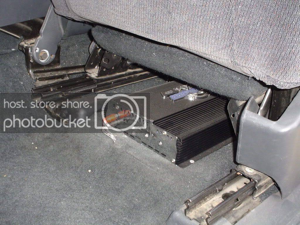

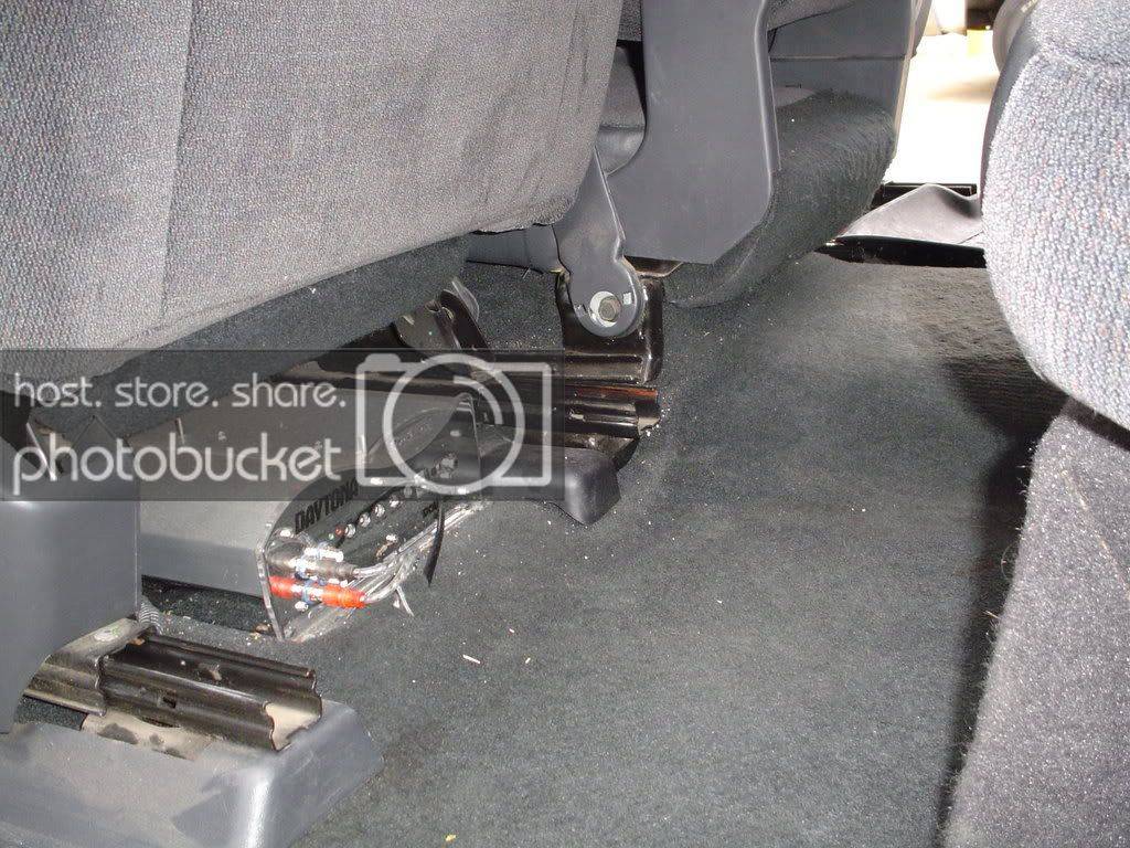

i have amplifiers under both front seats

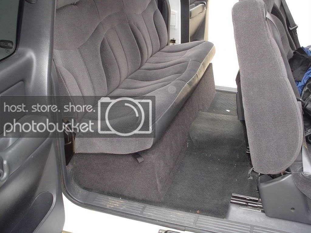

That sub box looks nice...

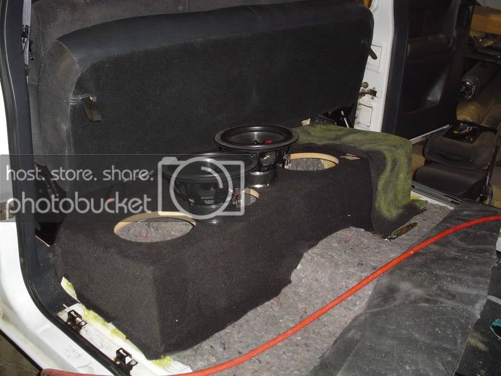

My 2001 Silverado xcab is currently in the shop getting some custom fabrication work done (sub box & some front door pods).
When I get it back this weekend I'll take some pics and post them on here...it's a downfiring box with (2) 10" TC-1000's in it
