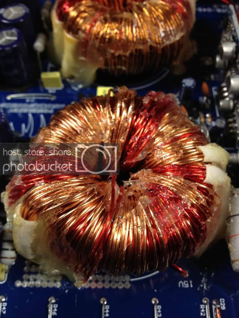

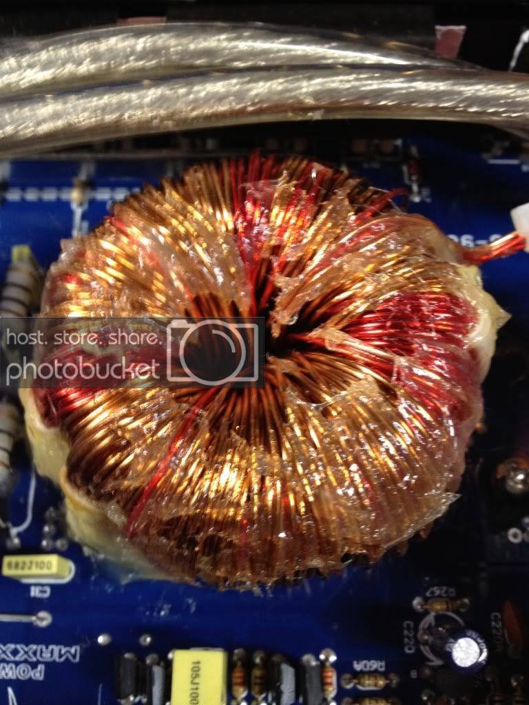

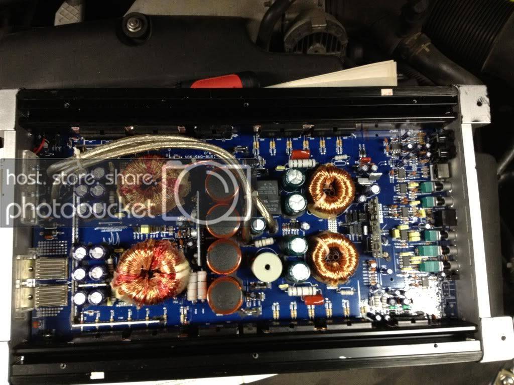

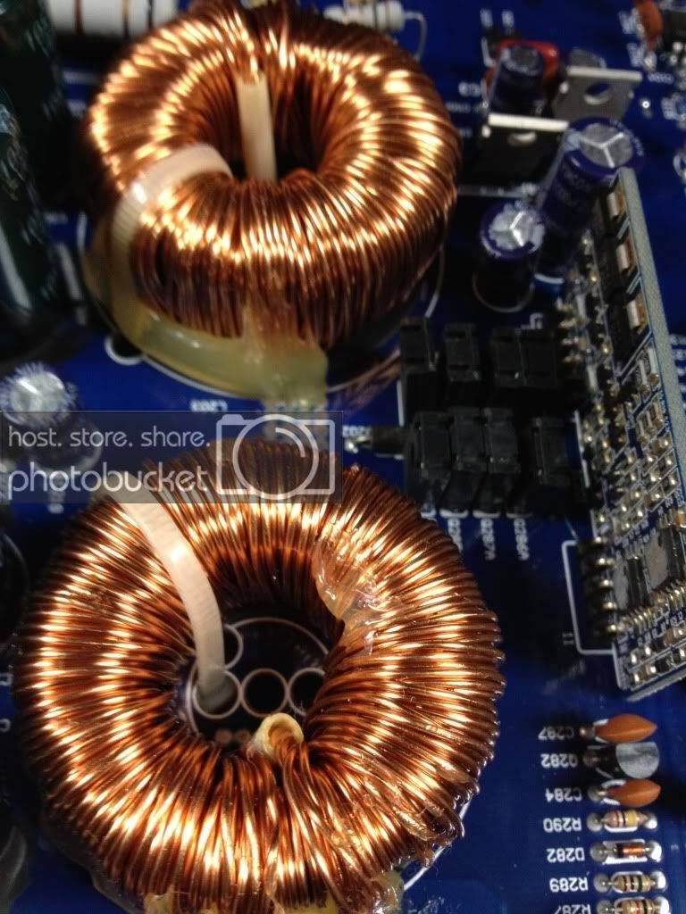

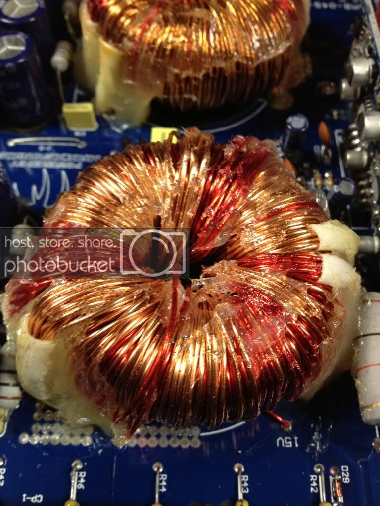

Looked at the guts of my amp, Anything seem abnormal?
xmakeafistx
Does anybody notice anything irregular?
I thought the doughnut like components looked a little unwound.. All of the stuff around it is glue.
Any comments on this would be great, just wondering if there is anything wrong with my amp. It seemed there wasn't that much output when I first used it. I got a steal on it.. so I figured there may have been something wrong. It works perfectly fine other than that. I was thinking maybe a misaligned gain knob?
EDIT: The warranty seal was not broken when I bought this, so I know it has not been tampered with.
I am no expert, but it looks fine to me. As far as low output. Use a dmm and a tone to set your gains. This could help to see if anything is wrong with the amp. And check your line out level the same way. I'd check everything I could, before suspecteing the amp.
I mean nothing looked burned from what I could tell, I didn't smell it either. Also I'm almost positive its not my line out, but I think i'm going to set my gains with a DMM and see where that gets me.

ok by the board it looks like a bxi1610d . those winds look just fine to me.
the glue is from running it in a harsh enviroment. it wont hurt anything but it sure does look goood

You will be happy at 2ohms for your sub.8ohms is like running a home theater of most.Amp guts look fine from what I can tell.Run at 2ohms, and see how it does.It is stable,and should perform quite well.I wouldnt be surprised that as the bass hits at 2ohms, that youd find unwanted dirt from the bottom of the surface of the trunk/rear deck..Lol 2ohms is where you need be at to get that woofer to sing.
Don't open your amp if you don't know what you're doing. If you thought the glue that keeps your torroids from shaking loose from the board during the bass they make was anything other than what it is, you shouldn't be opening your amp. Your amp is weak because it's a hifonics and it's running at 8 ohms. /thread
