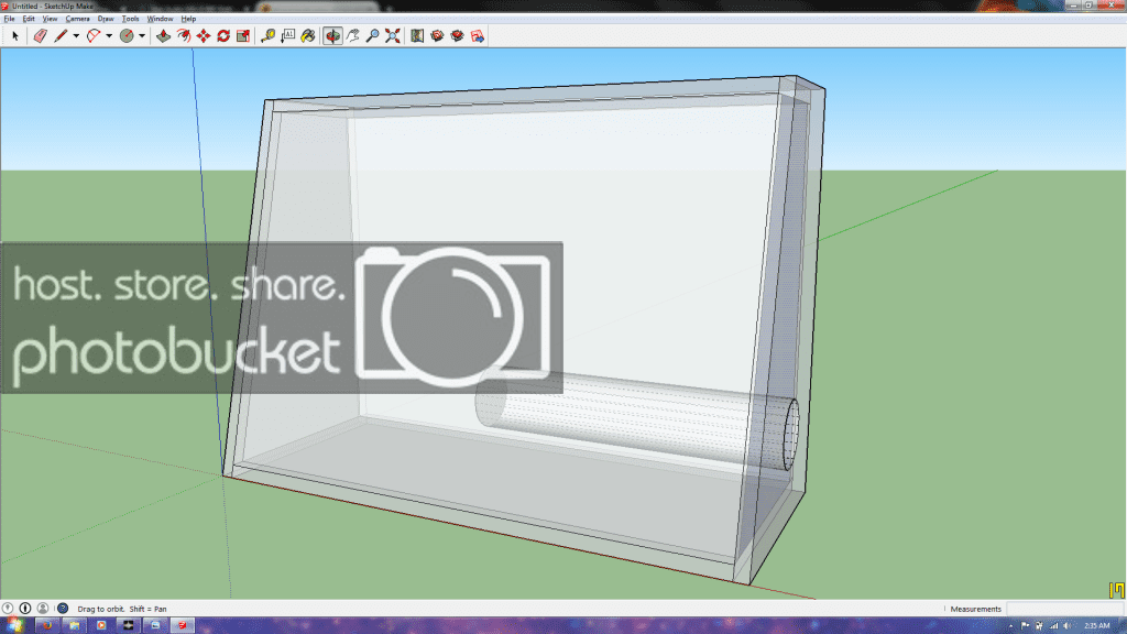

Never built a box, nor designed one. So be a little lenient with me.
Single cab Ranger, Skar MA8, 600WRMS.

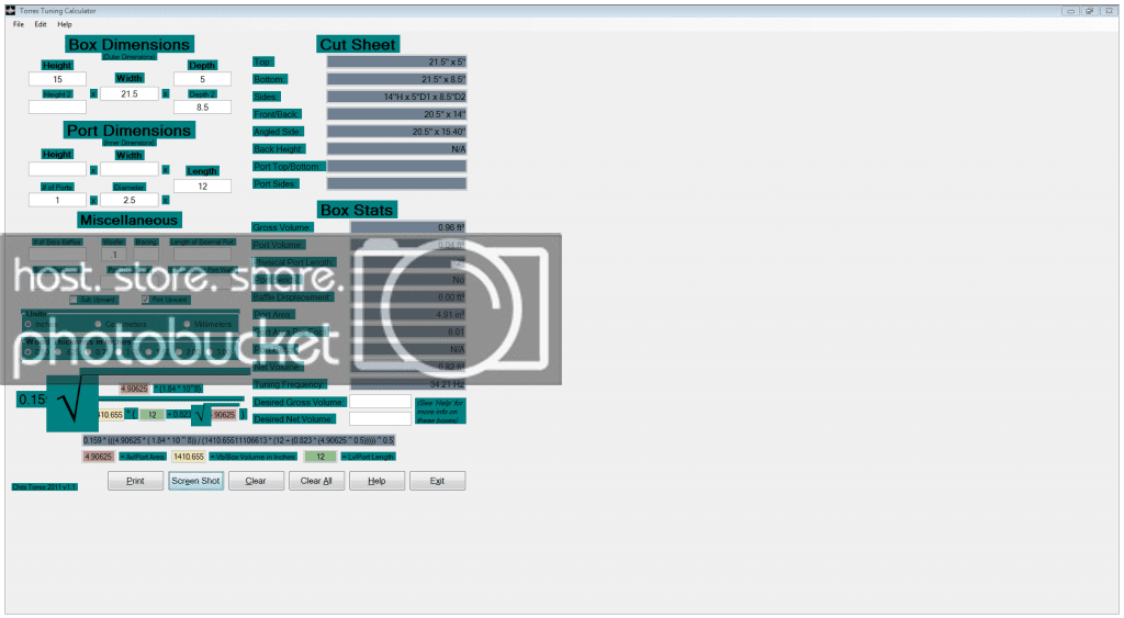

According to Torres it's .82 cubed, tuned to 34.21hz. It will be built with .5" birch.
15"H x 21.5"W x 5"(Top) x 8.5" (Bottom)
One 2.5" Aero x 12".
