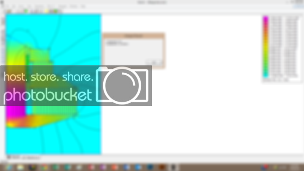

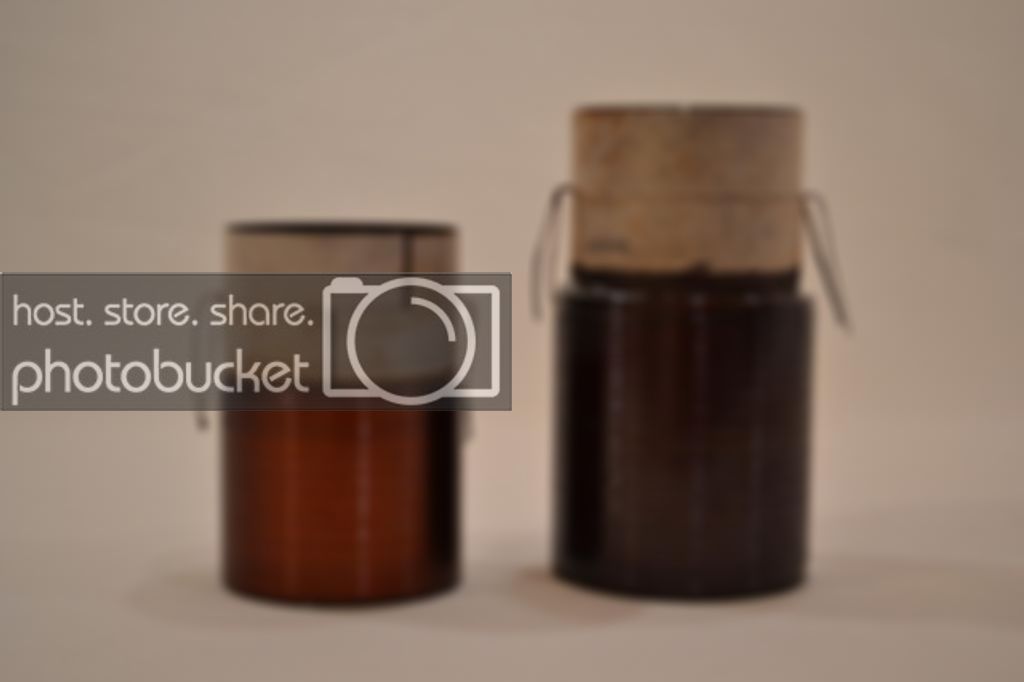

This is his thread on SSA about it. No T/S specs available yet apparently, and everything seems to be based off his FEMM model. Here are a few pics I found. Doesn't look like he has uploaded any FEMM models using the SPL coil yet though. Will be interesting once he does get T/S specs.
This is his thread on SSA about it. No T/S specs available yet apparently, and everything seems to be based off his FEMM model. Here are a few pics I found. Doesn't look like he has uploaded any FEMM models using the SPL coil yet though. Will be interesting once he does *edit* POST *edit* T/S specs.
Slight correction there. It's not when he gets T/S's, it's when he posts T/S's. T/S measurements are easily taken within a minute or two of a woofer being produced (from/by whoever builds it). Also if he has a FEM model he could post those anticipated T/S's (FEM spits out T/S's parameters - it's built into the modeling program). Even if the magnetizer he is using is off by a few percent it would still be nice to see the numbers. And while I'm talking about FEM, that flux image does not support a BL^2/Re of what he claims if that is the "SPL" coil in the model. But at this point we are all speculating what figure he keeps referring to since it is obviously not BL^2/Re.
I'm not going to lie, this is news to me. I have FEMM installed on my PC as well, and I am not aware of it being built with the ability to spit out complete T/S parameters. It will obviously give you BL^2/Re, but I do not see how it could provide a whole list of T/S parameters (ex. how would FEMM calculate Cms or Vas?)
As mentioned in my post you quoted, it does not look like he has uploaded any FEMM models using the SPL coil. I would assume the model he is showing is with the daily coil. However, I do agree 100% that this is all speculation until he comes back and provides an answer for these questions.

The FEMM model above is the daily coil. As previously stated the SPL coil will not be used due to induction so there is no need to have it Klippeled. I do not publish small signal parameters as they are not an accurate representation of a driver under power. The current sample I have is built to handle the SPL coil therefor the gap is ~3mm bigger than needed for the daily coil. This is why it has not been Klippeled as of yet.
The correct BL of the dual one ohm coil series is 19.4 TM at 1.6 ohms giving it a motor force factor of 235. (Reasoning for this is explained at SSA). Xmax of the driver (with daily coil) will be 37.5mm one way per coil over hang method. Per the 70% BL method it will be ~45mm one way. As soon as I have production samples built and tested by Pat Turnmire and I have a few current customers test it in the real world I won't have anymore information avaliable. Once I do it'll be posted in my section.
Just a quick bit of info until I get time to put it up in my section. The driver uses MMAG technology (think older striker pro with clear cap). It uses 25mm thick plates the main magnets are 270mm OD and the Diode magnet is 220mm. The current coil in it is an "SPL" coil to give it massive amounts of motor force. In this configuration it is around 2,800. However with this big 8 layer 95mm long coil there is a down side, inductance. Which we all know kills top end bass. Plus it just has too much force for its own good. The spider pack is twice as hard as an IA Warden and still moves ~15mm one way free air on 500watts. Efficiency rating on this set up is ~92 1w/1m and ~99 at 2.83 volts/mI will be tearing it down soon and putting in the "normal" MMAG coil which will give it a motor force factor around 400 and offer 42.5mm of one way linear Xmax. By June I will have engineering complete and tooling made for soft parts that will offer upwards of 60mm one way linear Xmax which will be needed to support the motor offerings that will be avaliable this fall. In the mean time this motor, if Klippel testing goes good, will be offered in beta form with 12 spoked baskets which offer ~32.5mm throw one way which i have Klippel graphs on and will be posting soon.
