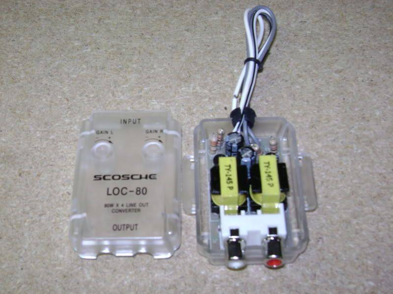

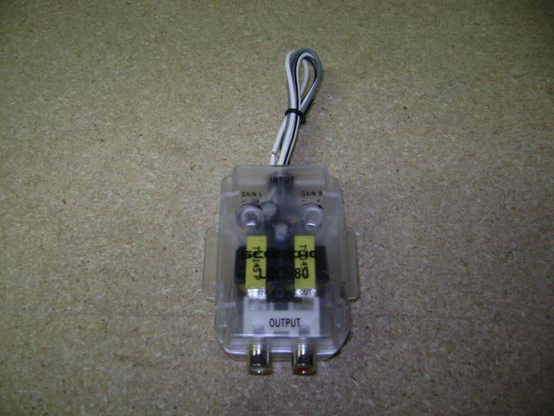

Line out converter
get the one channel ones and you splice them into your back 6x9 speakers...
and run the rca outputs to your amp.
They look like this
It should come with color coded wires.
simple install
