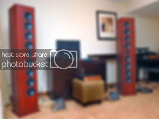

Line array has been started.

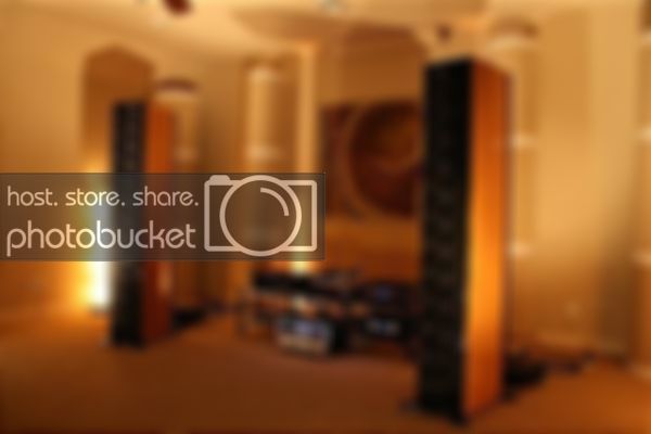

Danny improved his line array designs, sold on AV123
http://av123.com/index.php?option=com_virtuemart&page=shop.browse&category_id=36&Itemid=37
$6k/pair is a pretty good price for 'store bought'. If this was in a store only, it
would cost double easy, perhaps $20k/pair.
He claims that BG made custom Neo8 drivers for him. He asked them to mod
the existing design to improve some issues. I haven't seen any measurements to
confirm what the mod offers.
For DIY you don't have to follow that recipe. A BG Neo3 tweeter array would
be better, it's just a better tweeter. But because it's small, you need more to
make a big line.
... and the stock BG Neo8 isn't a really great driver.
