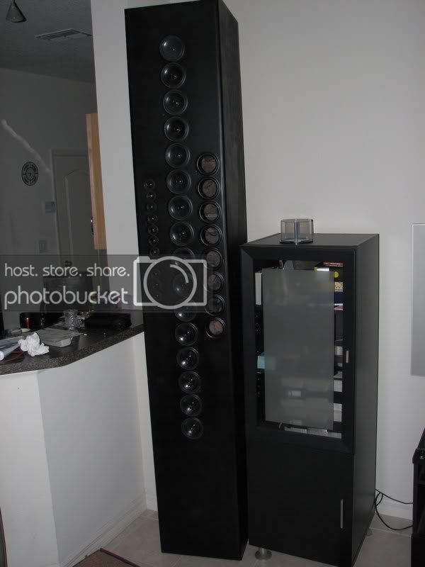

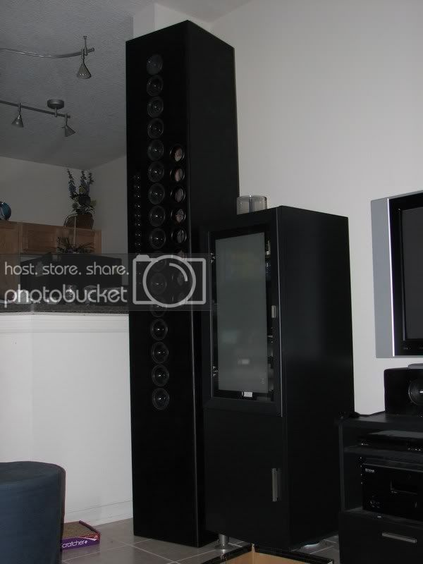

Thats pretty much it. I hit forks and toil over them until motivation just strikes and I make the decision. Right now my decision is the finish and have been trying many stains. We decided that no stain or coating will look good with our decor. We like things with a bit of industrial edge or modern. So black texture finish is the absolute final decision.
I have made a promise to have them 100% by Super Bowl. For now I will leave you with one picture.
6 coats of lacquer.
