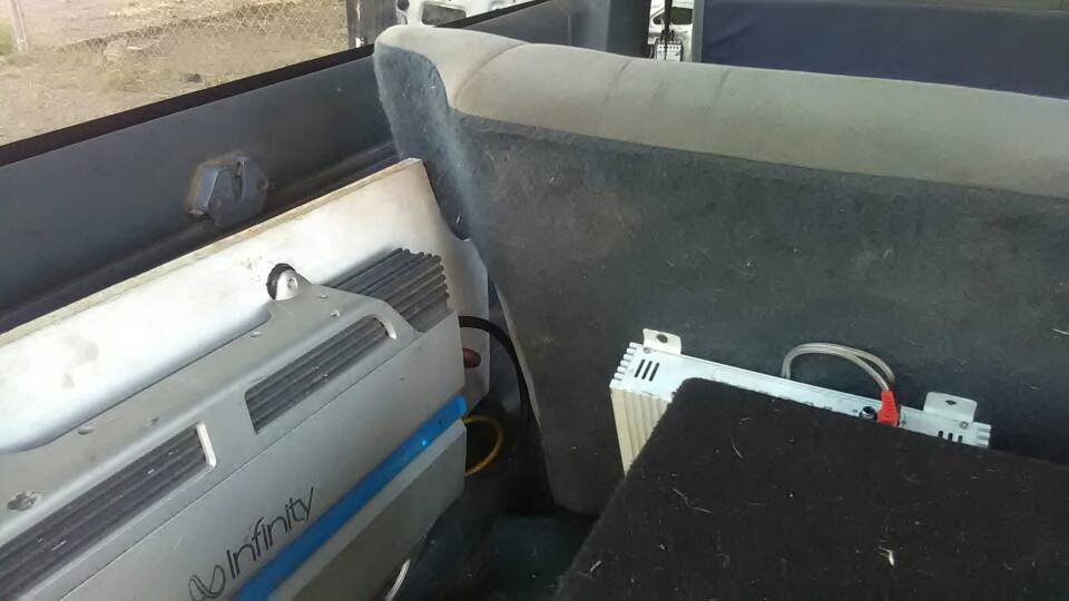

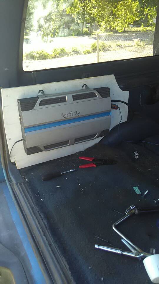

temp amprack just need to drill a couple more holes for the wires
