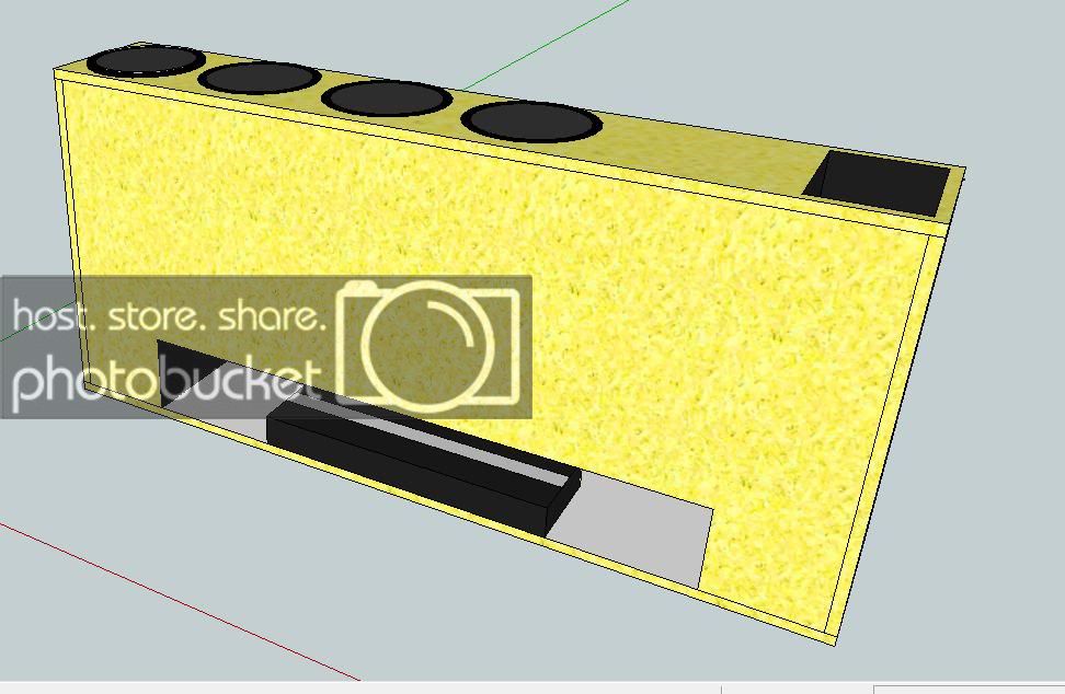

4 cuft after all displacements tuned to 32 hz the corners will have d3100s in them that is a saz3kd pictured in the middle drawn to specs will have plexi over the front if I can find someone to cut/engrave it.. Will have 4-8 fans to keep the amp cool as it will be behind the rear seats in a truck with limited air flow
it will be 10" at the base and top but they will be offset an 1" so over the distance there will be a SLIGHT slant.. 2.2 degrees to be exact
any comments or ideas are appreciated...

Port is on the wrong side, and most likely the box you have there will give you a very heavy low end if thats what youre after.
I thought port drivers side when doing trucks? although that is side firing.. why would I want to port passengers side? and while I want a nice low end I want it to come up the range a little bit.. I usually cut it off at 70hz at MAX so what would your recommendation be? tune to 35hz? or? any help is appreciated man!!
I had mine 34-35hz and they extended into the high 20s and up into the 50s-60s very well
