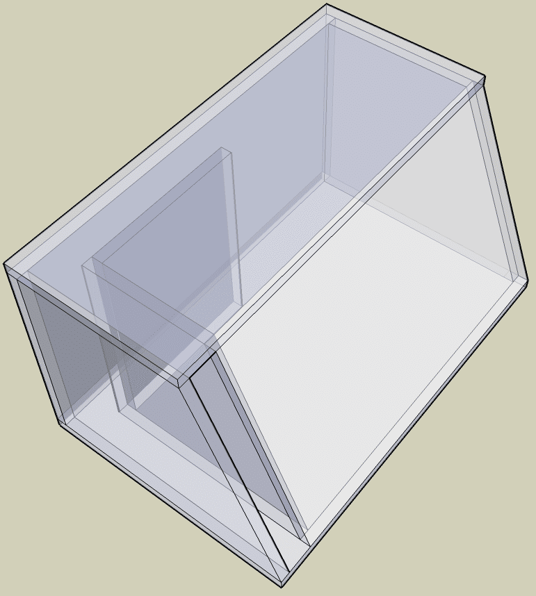

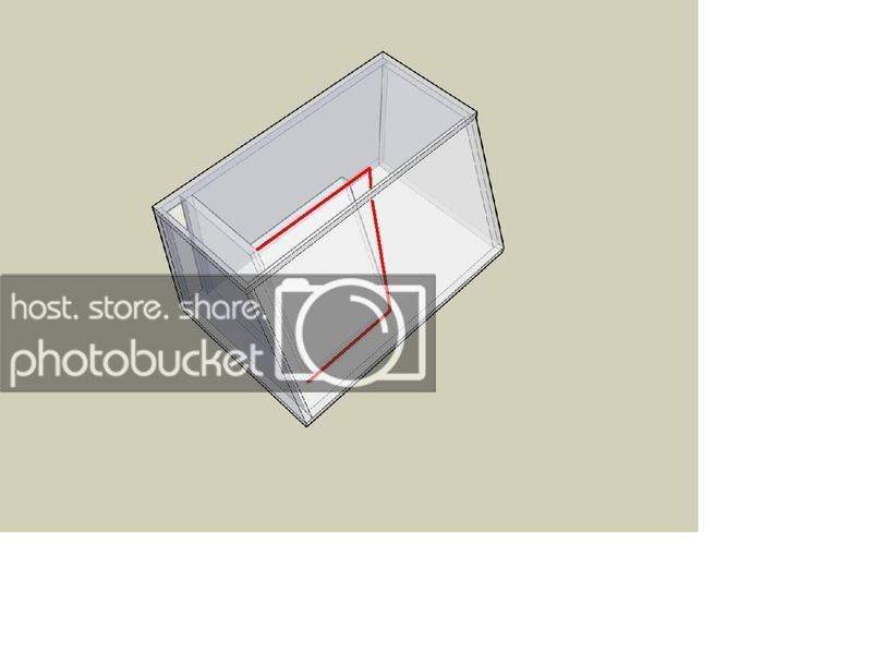

I want to design an L-port in a box with a Slanted REAR side... like the one below
How am I gonna make the calculations? Both WinISD and Bass Box 6 Pro do not have an option for L-shaped port... If anyone could help, desired Vb is 2.48 cu.ft. and Fb 38Hz.

You could probably calculate the p1 port volume using the angled box
calculator on bce. The p2 volume looks standard rectangle.

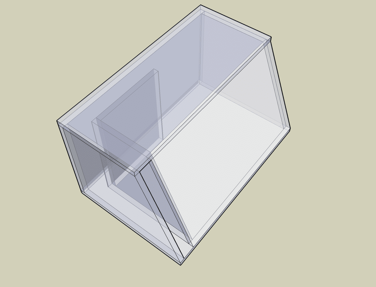

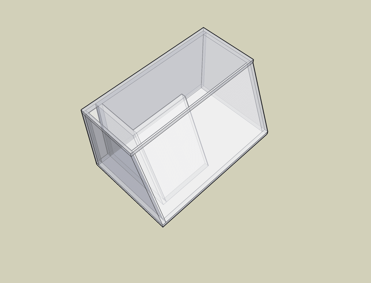

I see I see... The same way when I entered MTX's suggested ported enclosure measurements, RE calc showed 2.534 cu.ft. and 31.3 tuning freq. I altered the dimensions trying to keep the same vb and fb and came up with this front slanted box.
I need a rear slanted box so I moved port pieces in this way:
Is it the same?
Is it the same?

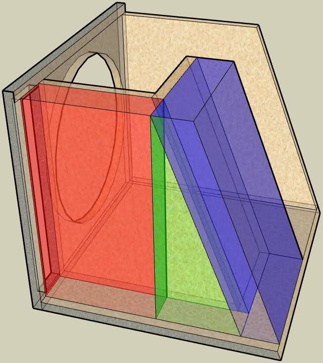

Yes.
Same "Green" area, and same port area.
Do the math, though. Stop being lazy. Section it off into 3 sections, 2 rectangular prisms, and one pyramid prism.
EDIT:: actually, the second one, the back part will be a rhombus prism.
Thinking about this, if you made the end of the port (inside the box) at the same angle as the slant it would even out the port length. I'm not good with diagrams so someone else would have to sketch it up if they understand what I mean

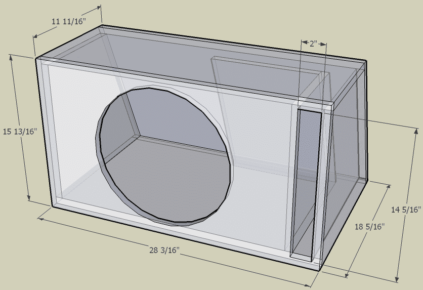

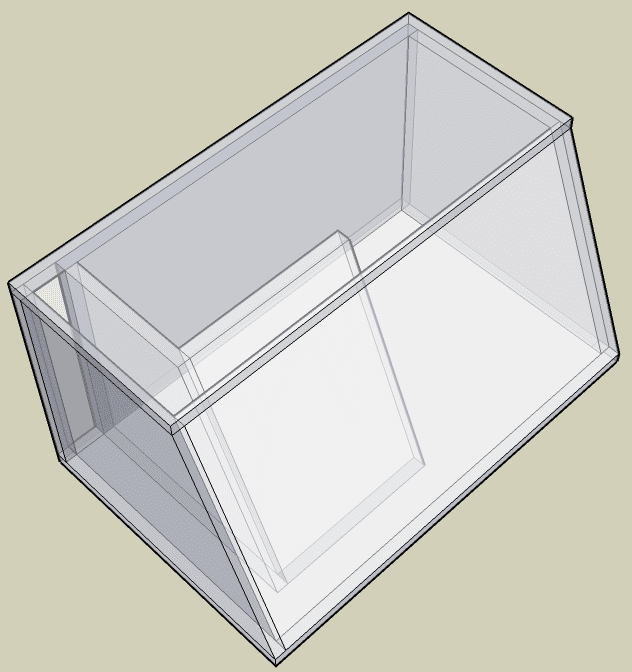

OK sorry for getting on everyones nerves but all I do the last 3 days is sketching boxes in Sketchup and messing around with BB6 and similar programs.
Now, I finally ended up in the box below. Given that the one RE calc suggests and this one are the same, I think this is the box to go.
If everything is right I'm going to get the cutout plans and start building it... Thanks for your answers and patience again.
