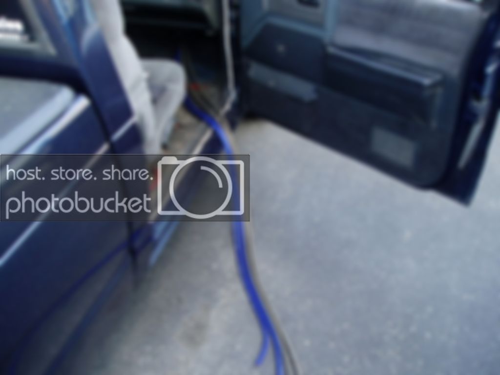

My grounds go all the way to the battery in the front of my truck. My grounds are 20 feet long (not exaggerating) and I don't lose ANY voltage from the alternator to my amp. Nearly every car chassis and body has the same conductivity as a piece of 4 gauge wire, and this has been scientifically proven.

Here's a pic of my wiring (both power AND ground wire). And guess what, not .01 volts of loss from the alternator post to the fuseblock in the cab.
