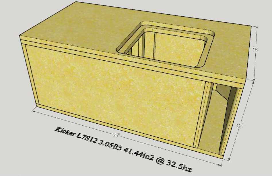

Featured Kicker L7S12 3.05ft3 41.44in2 @ 32.5hz (ported)
shredder1

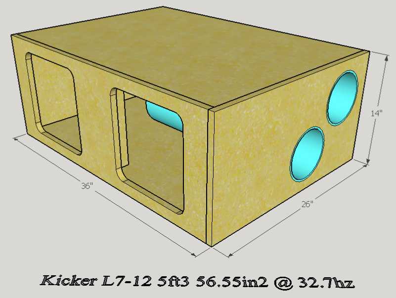

I cant remember what this was for but I felt pretty good about it for saving space. It's still 5ft3 net though. You can only compromise so much to do it right.
