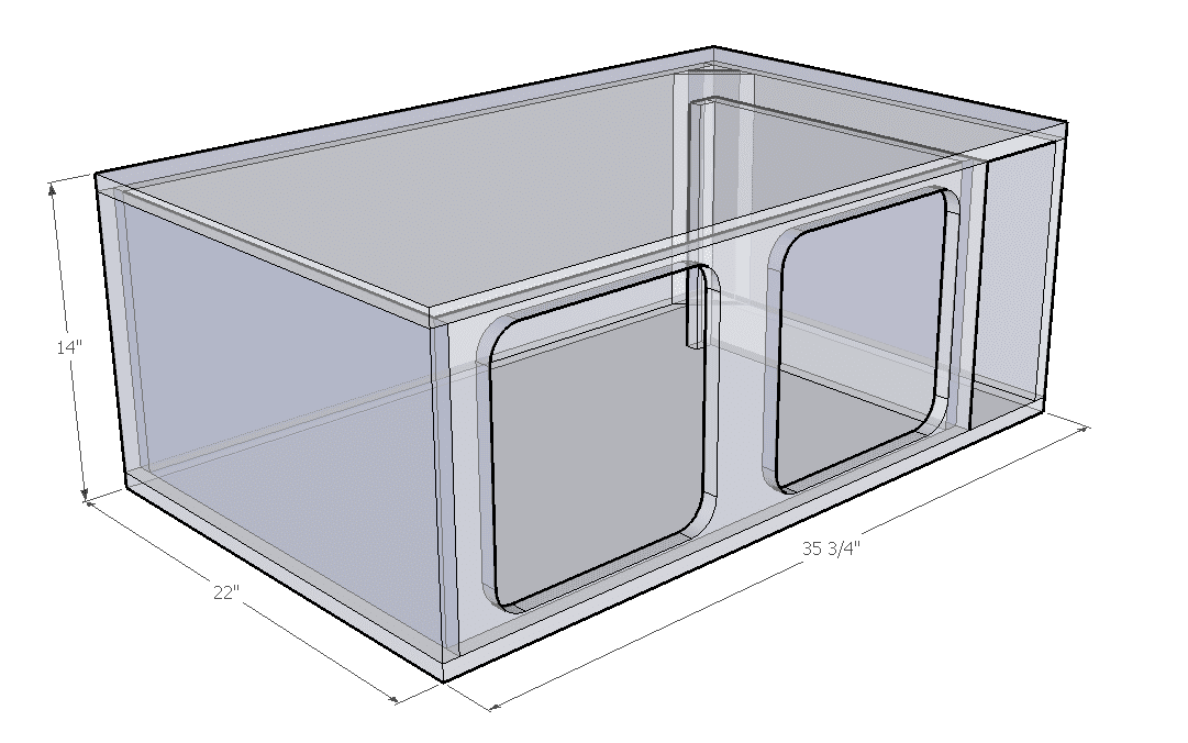

right now the box that i have is built by nolte audio, the dimentions are 33Wx13.5Hx18D, im not too sure what its tuned too, but im looking at building my own box, ive been to a couple different sites to figure out plans and everything but im still a little confused so i figured the great guys on this website could help me out...the MAX dimensions i can use is 36Wx14Hx22D, i am looking for each solobaric to go in a 2.0 C FT. box tuned to around 36 for each solobaric, they are 12", i went on RE audio website and played arond with the calculations,
with 35Wx14Hx22D and with the square port width at 4" and the port length at 8" it gives me 4.031C FT now how will i know what it is tuned to? if someone could help me out and help me build a box id appreciate it, thanks!

Does that look good to you?
It's 4 cubes after displacement tuned to 36hz
yea that looks good, now i have a few questions, is that a good thing to tune it to 36 hz? this will be for daily, should i tune higher or lower? and can you tell me the length and width of the port itself, and then tell me the length of the wood going from the front of the port close to the back of the box?
It's a fairly good tuning to daily.
