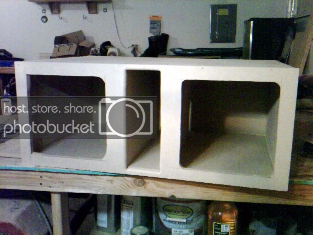

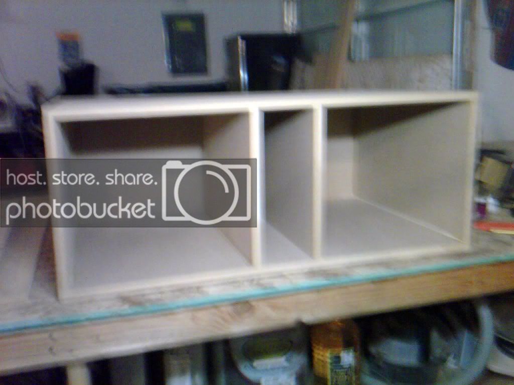

Still gotta carpet the box and do some minor touch ups.... but here she is!
