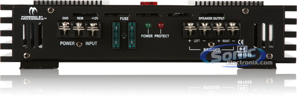

Yannoh I have them wired now from each of the spreakers to the amp so all of my ports (4) are wired and I can see we're it says bridged, and they hit pretty hard, but only on the highs and some lows of some songs, but you think it could be just my box? Or would bridging them make them hit lower bass?
It shows the bridged formation under the terminals:
Also keep in mind that amp is only rated to be stable at 4 ohms bridged, which you can't achieve with those subs, or a high impedance load. Wiring to 2 ohm, you'll want to be very careful in most cases.
Edit: My bad, I thought you said you can't see where it says bridged.
Yeah so I have them wired + and - from one speaker to + and - on the amp same with the other speaker. Would it be best to get another amp? Or a new box? Or bridge the amp?
