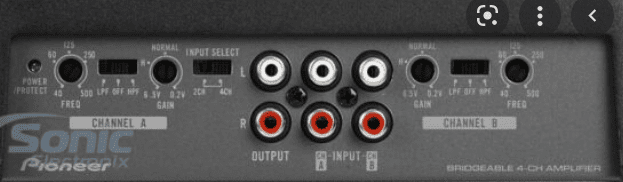

i have the below amp
its powering 4 pioneer speaker model 1675v2 which runs within 35 Hz to 20 kHz. ive set HPF on the amp. so, where should i set the frequency knob?

80-100 is normal if 80hz makes them sound bad start going up
There is a reason that amp has 80 and 125hz marked it's common crossover points

Your HPF setting will depend greatly on what size speaker you are running, how much power they are getting, and the install.
I have my 6.5" MIDBASS drivers HP at 60hz and LP at 350hz. My 3" MIDRANGE drivers are HP at 380hz and LP at 4000hz, and my tweeters are HP at 4200hz.
If you don't have deadened and sealed doors, setting your HP below about 100 is mostly useless and can lead to damage. If you are running 6x9 speakers they generally tolerate a HP of 80hz with no issues.
The pioneer speakers you listed will not do well playing below 100hz on anything more than 20w or so.
You are also wiring 8 speakers to a 4ch amp, so unless you are running a the left doors on ch1, right doors on ch2, left tweeters on ch3, and right tweeters on ch4 you are going to have problems.
