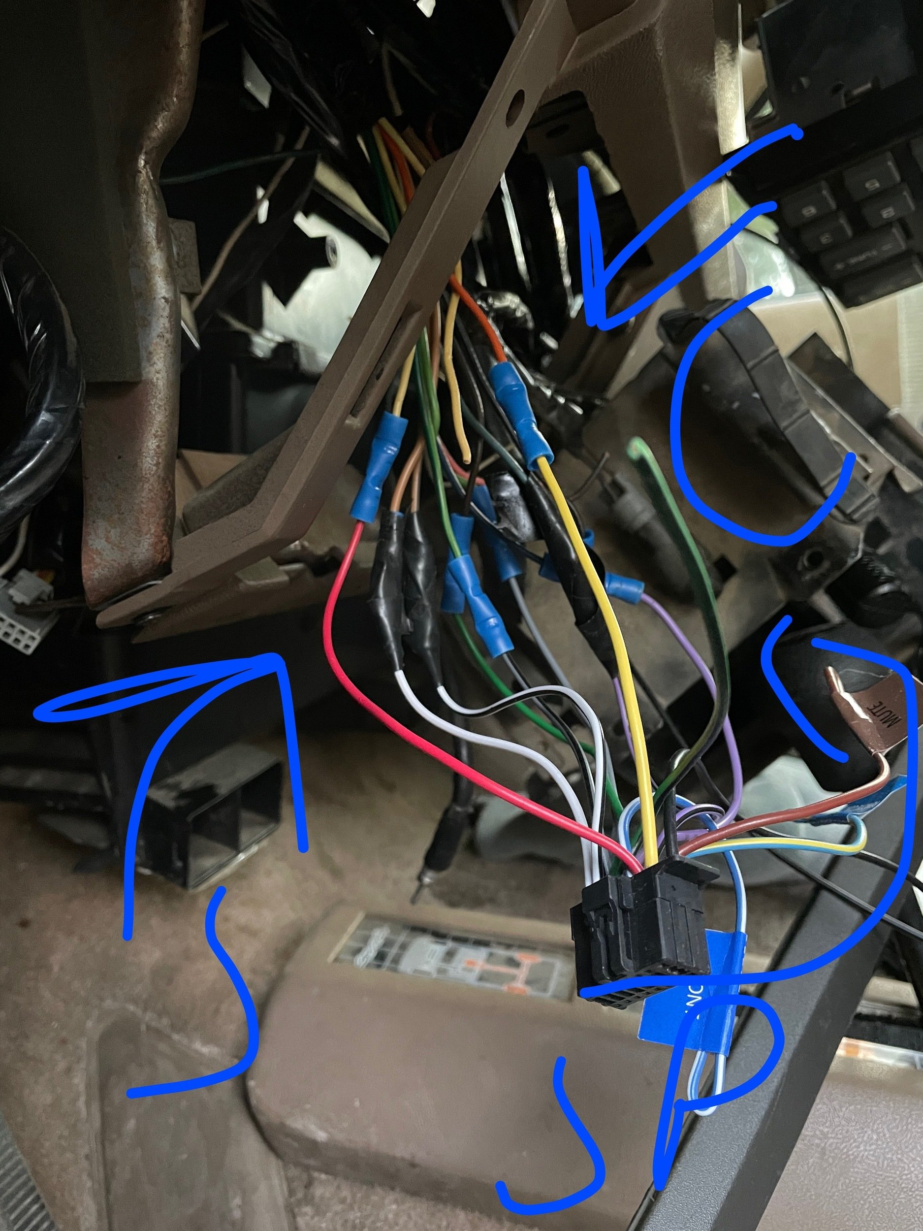

I decided to wire my old kenwood into an older suburban, after having a few hiccups, I finally get the radio on, but the only thing it does is say “miswiring, check wiring, then power on” could it say that because I didn’t plug in the antenna cable? Or did I mess something up? Tomorrow I’m gonna check the fuse in the radio, the remote cable (might just wire it to the cig lighter or direct to the battery) or my ground (wired to the original ground in the truck) any other suggestions? That would really be helpful

I hooked the constant power to the big yellow wire, hooked the switch to the red wire (on the harness) still the same issue. Here’s what I’m working with now.
C = constant
S = switch
SP = Speaker wire
EDIT: the yellow wire fell out of my harness, could that possibly be it? As you can already tell, I usually get the clip on harnesses

So I checked the ground wire. And god*am*tt, the frekin ground wire had wiggled out of the connector. Put a new connector on and everything works...
