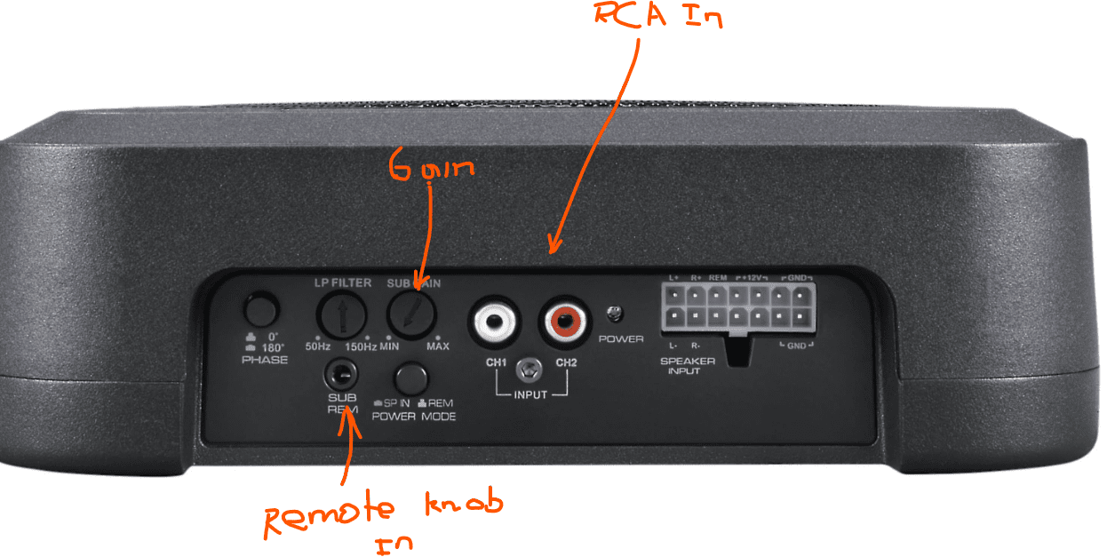

Hello guys!

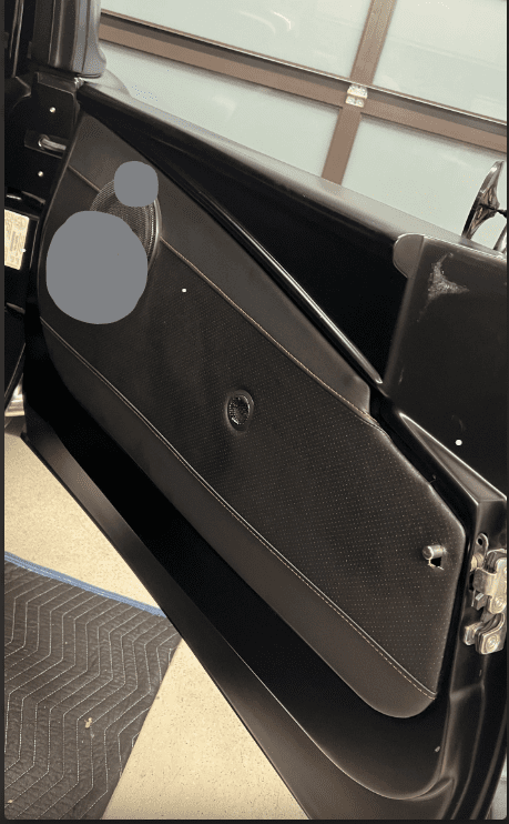

I have very limited space in my custom build Hot Rod, so I am using Kenwood KAC-M1824BT amp.
Only two speakers in the front doors Focal 2-way component system. They sound ok, but no mids and no bass at all!

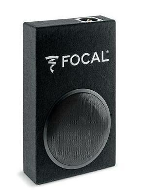

So I am thinking to add a Subwoofer. This Alpine PWE-S8 or similar will fit perfectly under the dash.
How can I configure this amp and subwoofer to get best audio quality?
Thanks in advance!

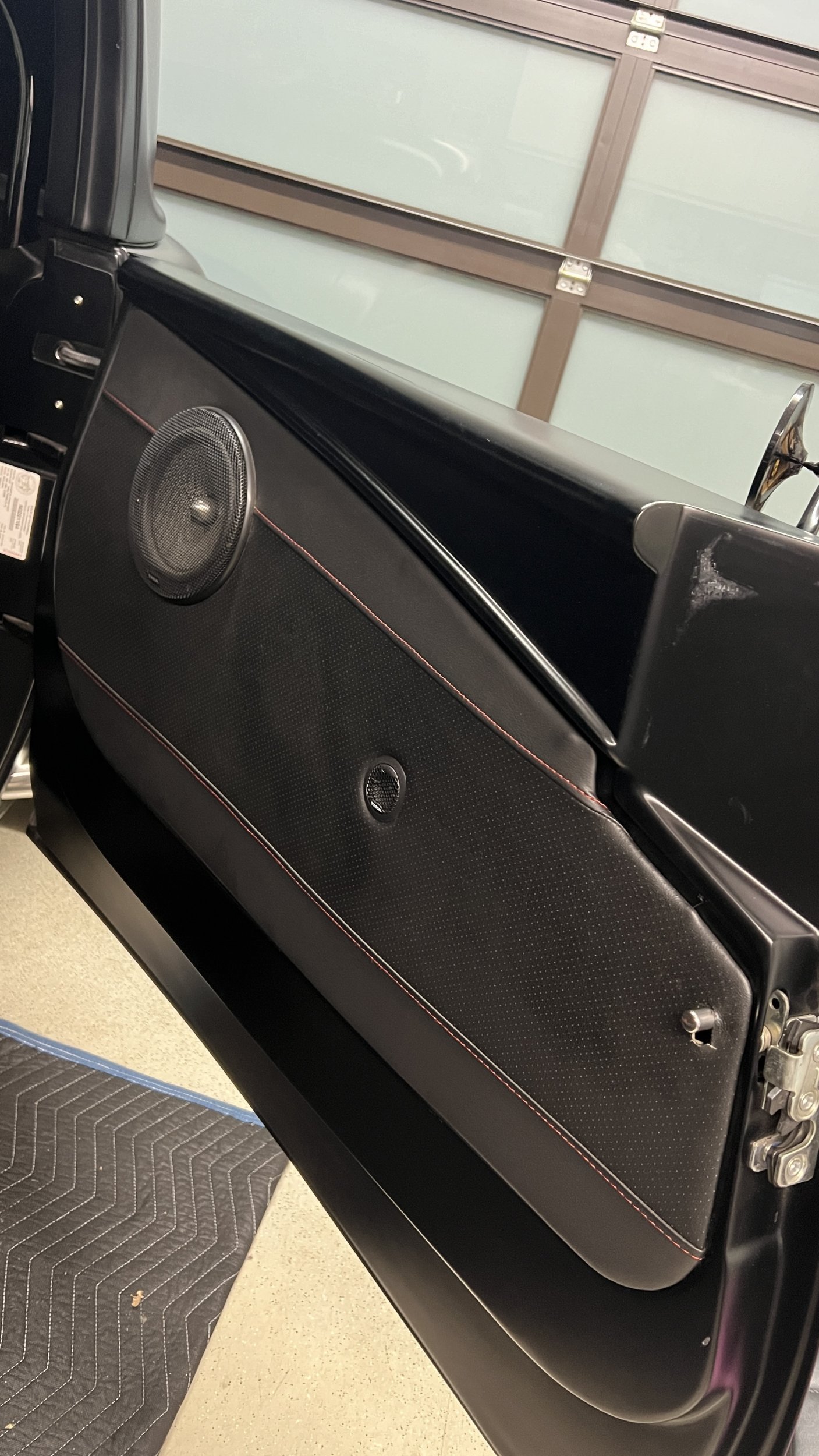

Hate to say it, driver placement is amiss. Right beside, preferably above and below like this:
You have really broken up the stage locating them like that. The other issue one runs into on the old jalopies is that the doors have a lot less airspace behind them, this reduces any midbass low end extension one might get in a bigger door cavity.
What happens when you put these that far apart is the crossover point (wanna say around 2200-2500?) is diminished as the tweeter and midbass driver are not close enough to assist in bumping, normally suming in that narrow passband range between the high end of the midbass and the low end where the tweeter picks up. More like two speakers doing their own thing instead of two speakers acting like one.

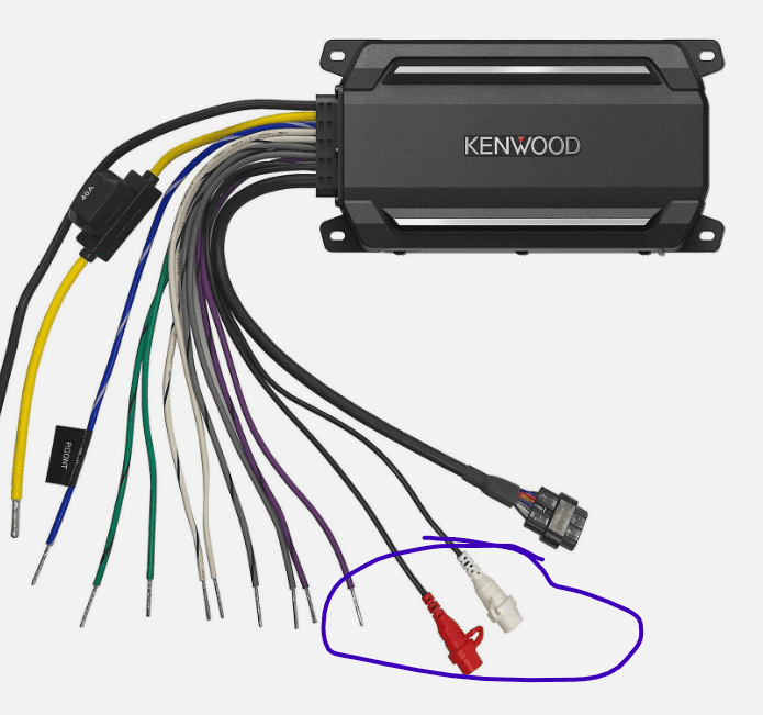

Bridge the kenwood to the focals if you haven't already, that gives you 150x2 to the focals, add the alpine and play with positioning to get the most from is. Another option depending on room would be to get one of these:

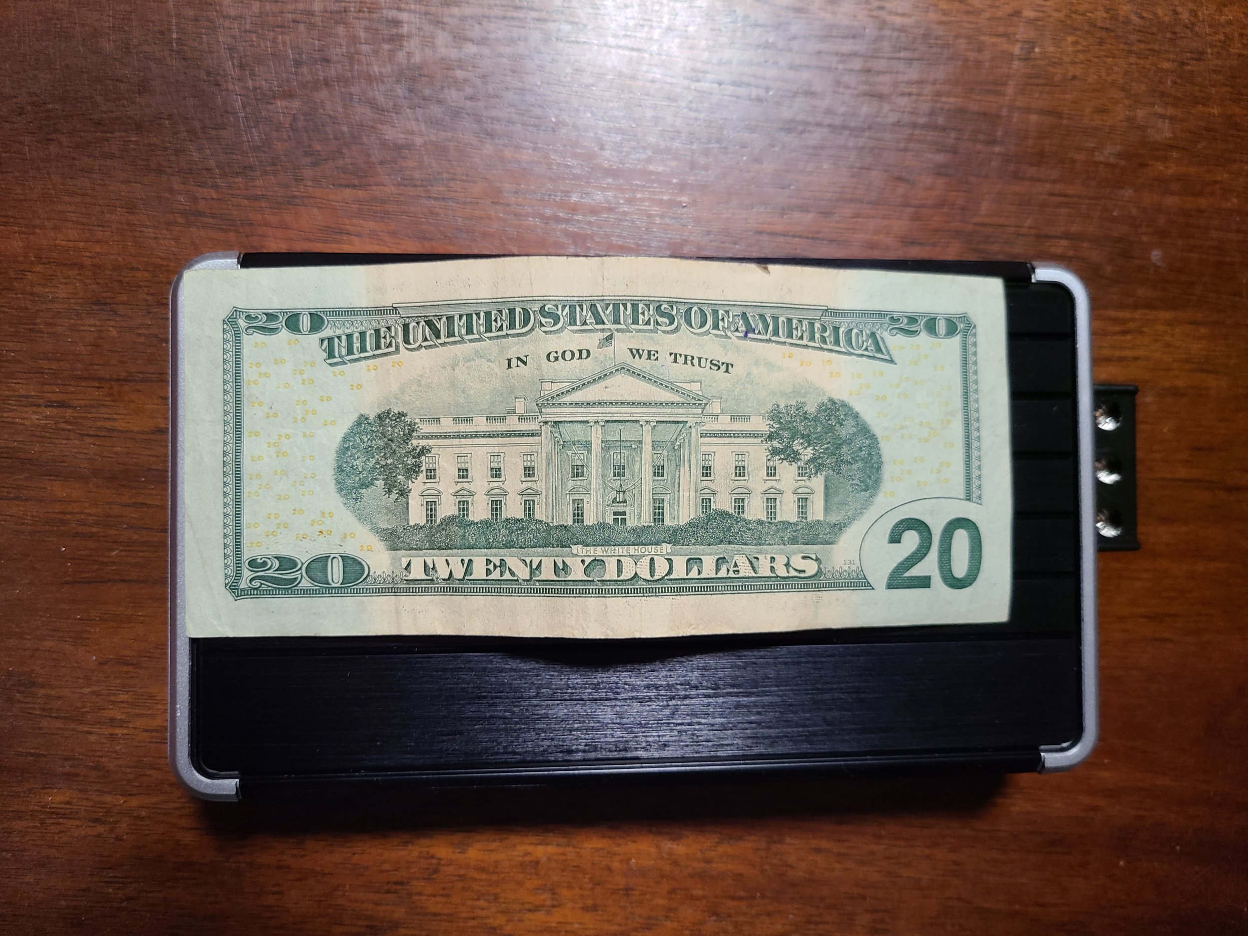

Amazon product ASIN B01E5TO9TY
Perfect tiny little amplifier that puts out about 250 at 4 ohms.
That is slightly more $$ than the Alpine powered sub, but not by much and would be a perfect compliment to the focals up front.

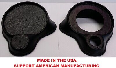

Unfortunately I cannot relocate speakers/tweeters. Instead I can install 6.5" 2 way speaker and leave tweeter there just to cover the hole.
The reason I got that amp is bluetooth and its very small.
Space under the dash is about 13" x10" and Focal PSB200 will not fit...
That would likely improve the sound. Make a decorative 2" cover for the tweeter holes, many out there...
and sell the comps!
Add the alpine and good to go!

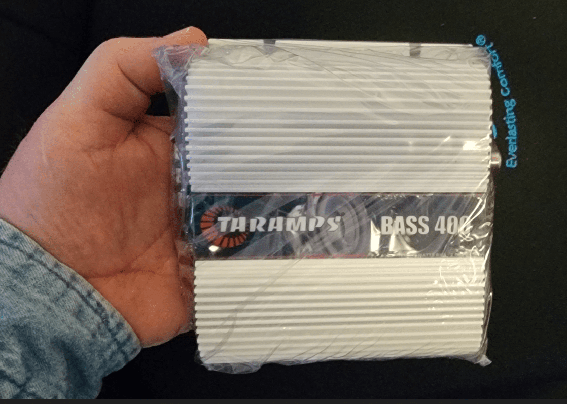

Not sure what you want for bass. That powered enclosure you listed might do enough to add to sound quality, but don't expect to feel anything. If you have room to mount a real sub, you can find really small amps that have decent power. Even a slim sub is going to do more, but I'm sure if space is a concern, your electrical probably is too.
Here's one I have that does 500w x 1 RMS @ 4ohm 7.7” x 4.0” x 1.4”

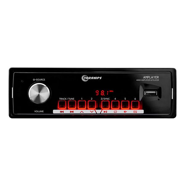

Sony makes em, and the looks of this might be a little more hot rod than all the other new stuff.
This one is 68w x 4 , or you can even bridge it 200w x 2 @ 4 ohms, but 68w is right what those speakers need.
