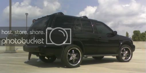

Was browsing through some forums and found this. Now, I hate lowered cars. I think they look terrible. However, this looks great IMO. Lifting isn't really an option because pathfinders are unibodies which means that unless I want to do anything over a 2" lift or lower I need to do some frame mods which includes welding, and I have 0 experience with that stuff.
Anyways, at some point I'm gonna want to lower it and possibly murder it out...not sure if I want to murder it or storm trooper. In the end it will probably look like this:
but lowered a little.

my jeep is a unibody and i can get all the way up to 10 inch lift without having to do any major modifications. you just have to go with a suspesion lift instead of a body lift. at least that is the way it is with jeeps anyways and they are unibody. but maybe the pathfinder is different, was looking at some lifted pathfinders and they look pretty badas$ lifted.
I'd love to do a 4" or 6" lift on the pathfinder but every build log I've seen of one had to have some serious modding done through welding etc. I'm sure there are kits that will do it and maybe the build logs are for people that wanna do it themselves to save on cash?
