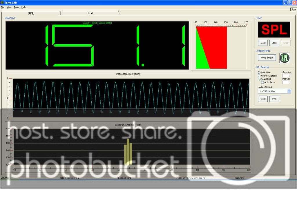

one 2500d @ .5 ohm, sealed @ the dash 148.7 (or 149.7 I couldnt tell, sun was glaring on laptop screen, but all other #'s were in the high 48's so lets call it a 48.7)... quick outlaw score did a 151.1.
