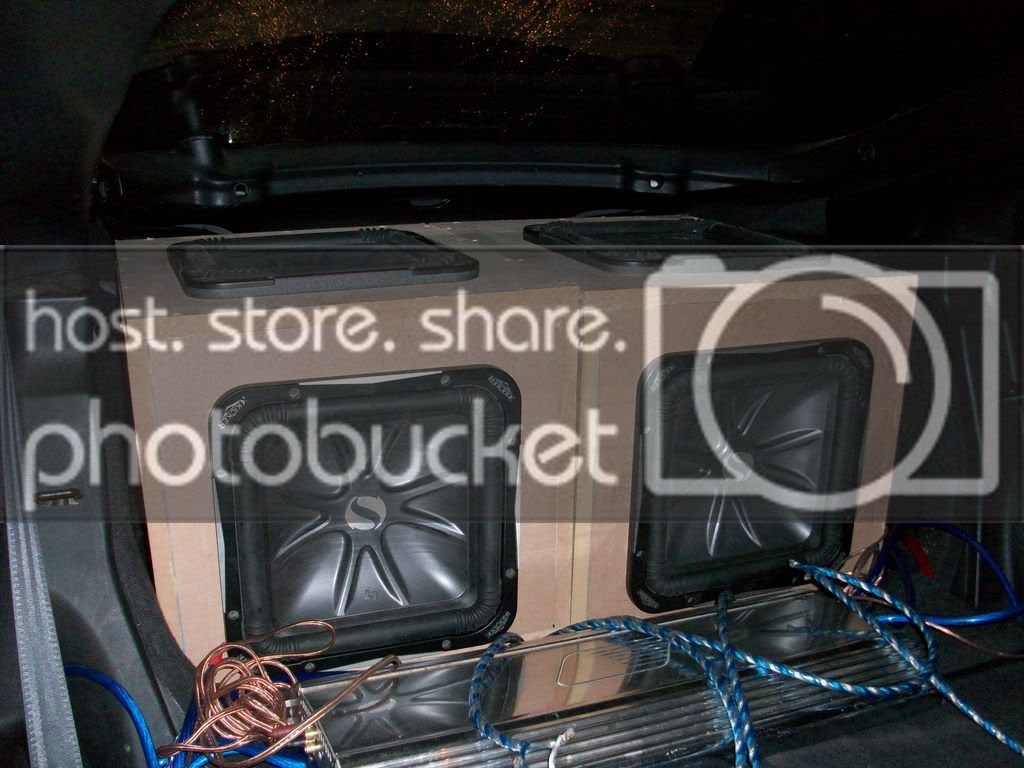

just finished up my four L7 12 build :)
small box+ lots of power = happiness.
bingo
fwiw I had my MT 18 dual .7 in about a 4 cube box with four 7" aero's doing 153's at the dash, feed each coil a 2500d and the small box didnt really make much diff ;)7
and yes its more for burping than anything else... get the guys in here with crx boxes and four L7 12's and they will be giving you smaller sq ft than I have for sure.

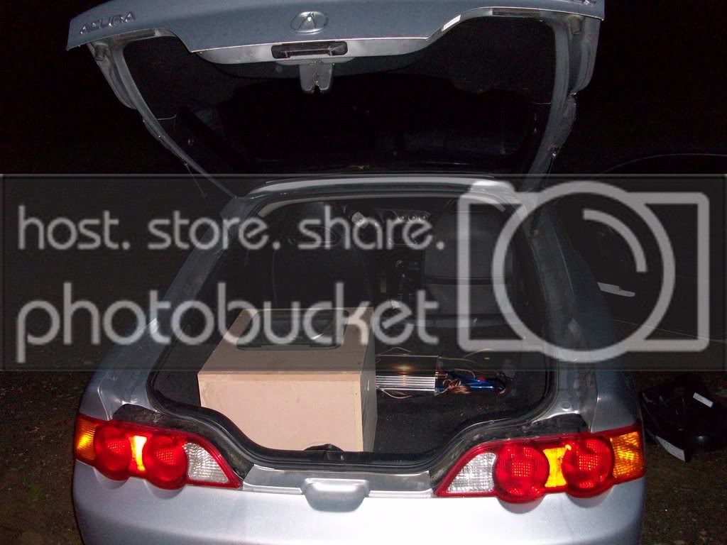

yes hatchback, 02rsx

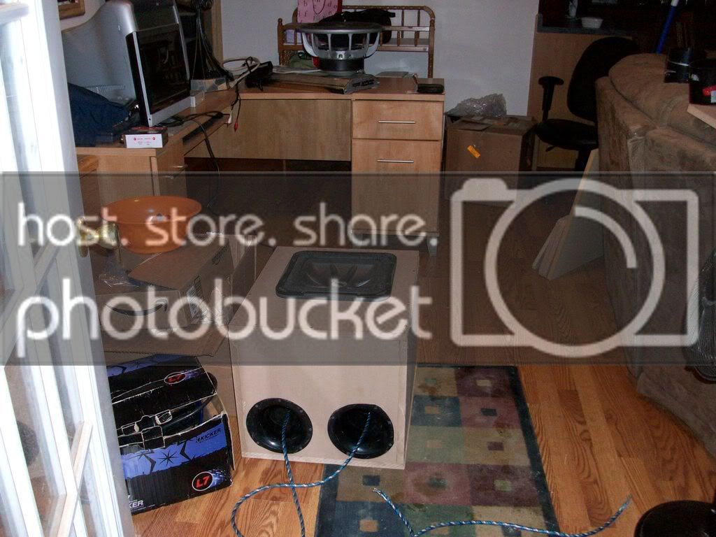

yeah I got to Home Depot @ 8:30am and am now just finishing it. I put together a box for my buddy who went to Lowes and asked for 3/4" MDF and he ended up having the "technician" get him 5/8" Particle Board //content.invisioncic.com/y282845/emoticons/laugh.gif.48439b2acf2cfca21620f01e7f77d1e4.gif//content.invisioncic.com/y282845/emoticons/frown.gif.a3531fa0534503350665a1e957861287.gif but I did that and it came out ok, had a few stray pieces that were a tad too long but he said he would take care of that //content.invisioncic.com/y282845/emoticons/smile.gif.1ebc41e1811405b213edfc4622c41e27.gif did a flush mount with the sub (L7 12 old gray cone)... anyone want pix of that?

and still not wired up to the amp yet, i honestly have no clue where I would put a second 2500d, its retarded how little room I have in this pile of no room having car //content.invisioncic.com/y282845/emoticons/frown.gif.a3531fa0534503350665a1e957861287.gif

hell with golf. but your build looks real nice man would the other orion fit on the ported side of the box?
then i'll have about 1" between the back of the box and the amp //content.invisioncic.com/y282845/emoticons/frown.gif.a3531fa0534503350665a1e957861287.gif
its a tight fit playa!

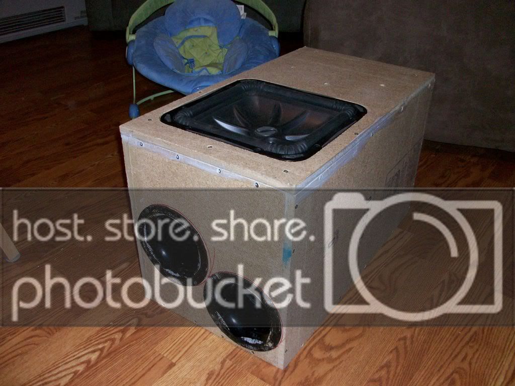

here are the other L7 box pix with the particle board
lol
kind of ugly with some excess liquid nails that dried a bit before i could wipe it off, but he is going to do some textured spray paint on it after we fill in the screw holes with wood filler etc etc...
haha i dont have the right size ports in there right now, they are about 3" shorter than I need them to be. the boxes are 16.5 tall x 18 wide x 22 deep. two 4" aero's that are about 10" long right now per box.
