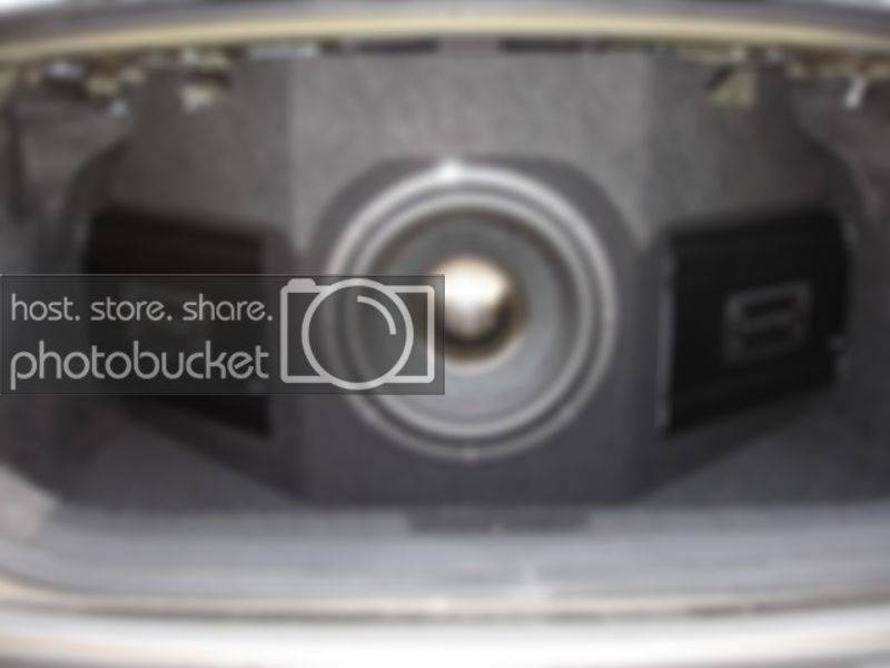

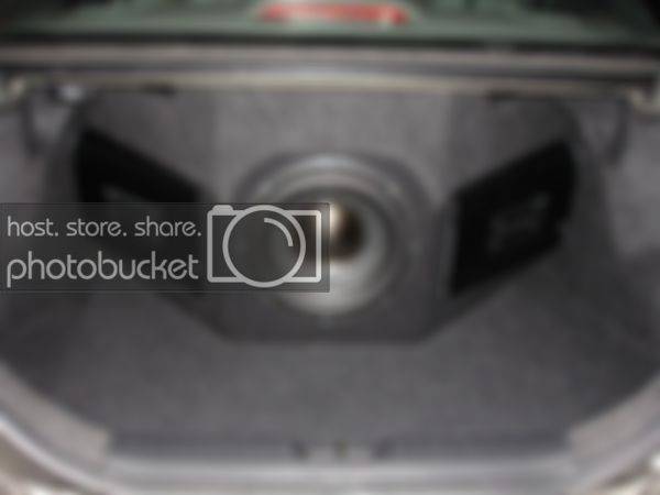

Not mine but a fellow 8thGen'er:
W12GTi and eD amps (Nine.2X and Nine.1) I am proud to say I am one of the main influences behind him getting this setup.
why ya sellin it? i read on there that you love that sub...
