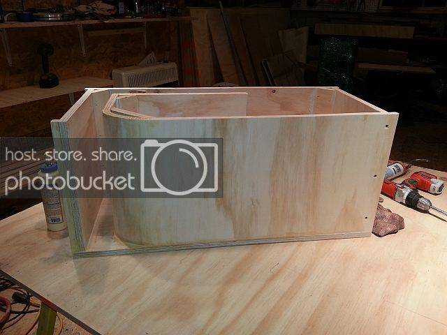

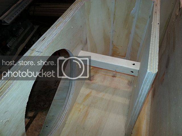

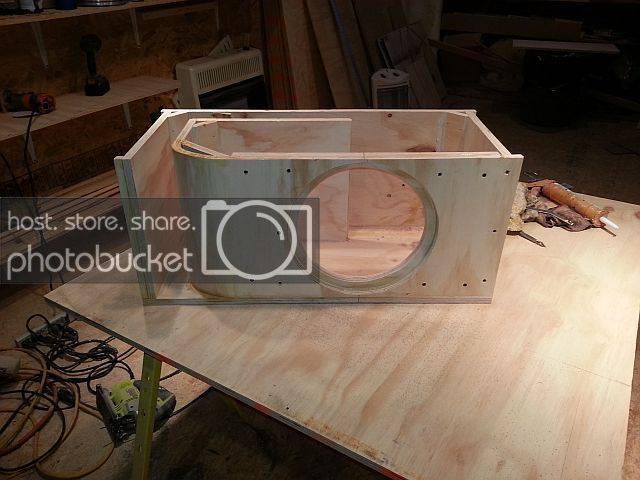

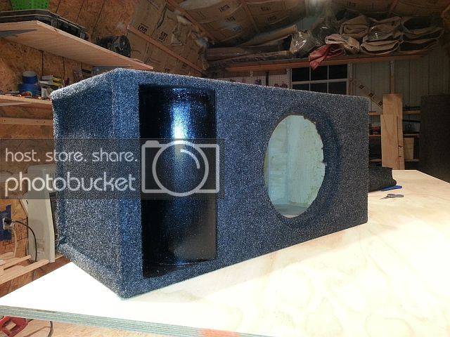

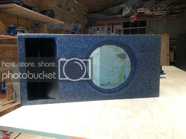

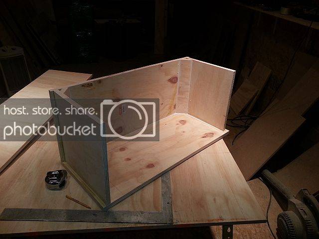

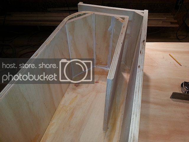

Uno SA 12" Enclosure........2 cubes net....34 hz......Arauco construction, flush baffle mount, kerfed port, brass bolt connections and wrapped in dark charcoal eventually....
How much did this run him? If your at liberty to say that is.
This is exactly what I requested from a local guy here and I didn't really like his quote. I've seen the resident SMS "huggers" and I see why now. lol.
Nice build BTW. Do want.

His was $160 shipped as you see it above....yours may vary a little....depending on shipping costs.......thanks
