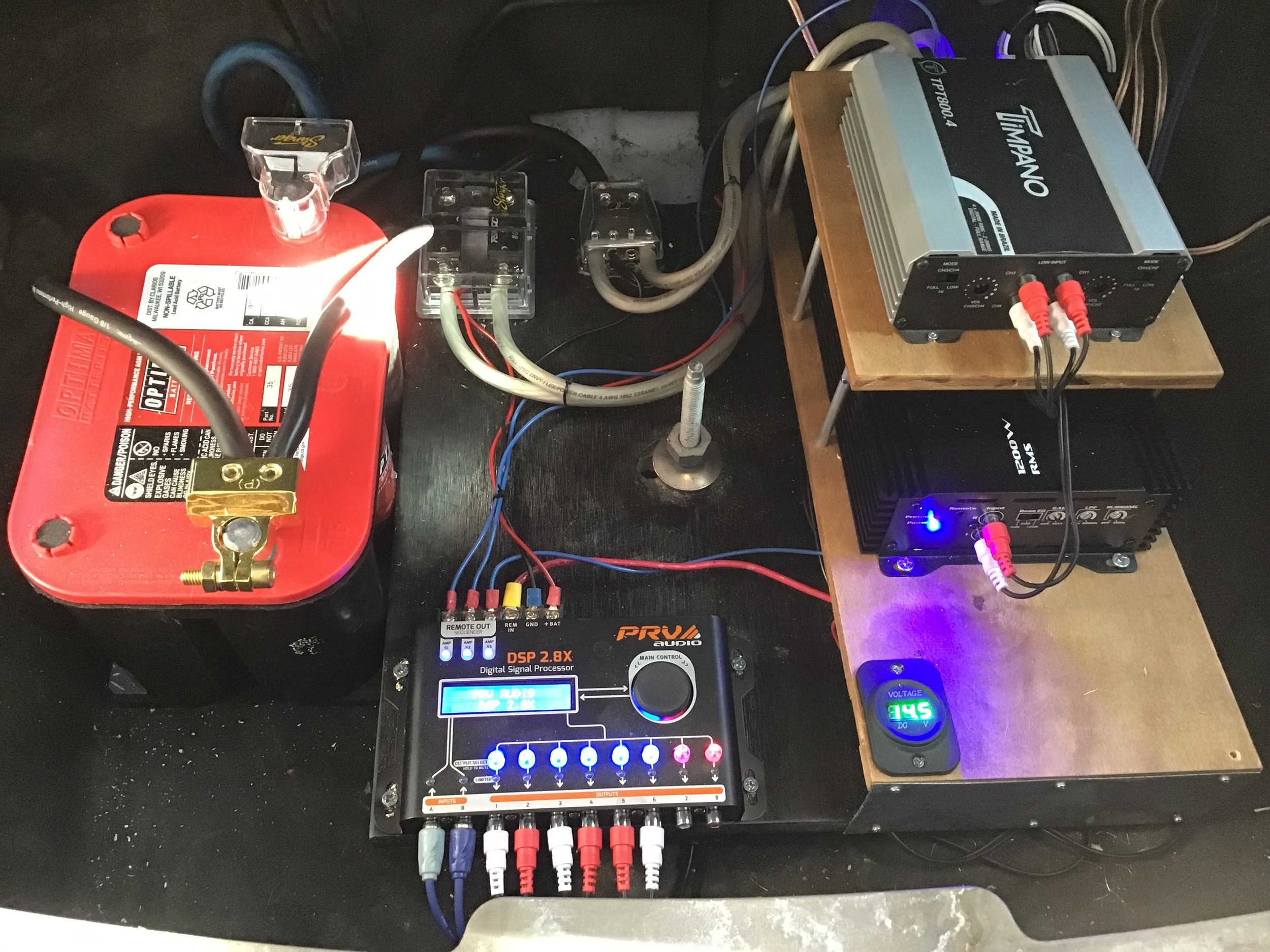

Yeah. I’ve been messing around with test tones on the DSP. The Skar amp is getting hot but the sub isn’t.

do you have a voltage gauge by chance? If so what’s it reading under draw?
I’m dropping a full volt down to around 13.
going down to 13.5v shouldn’t cause it to get hot. How hot we talking here? Can you keep your hand on it or is it too hot for that. Mine doesn’t get hot enough to where I can’t touch it. Now that it’s getting cold it really doesn’t get that hot at all. In the summer different story.
It’s just hot to the touch. Not hot enough to fry it. I played it hard for probably 3 hours also.
