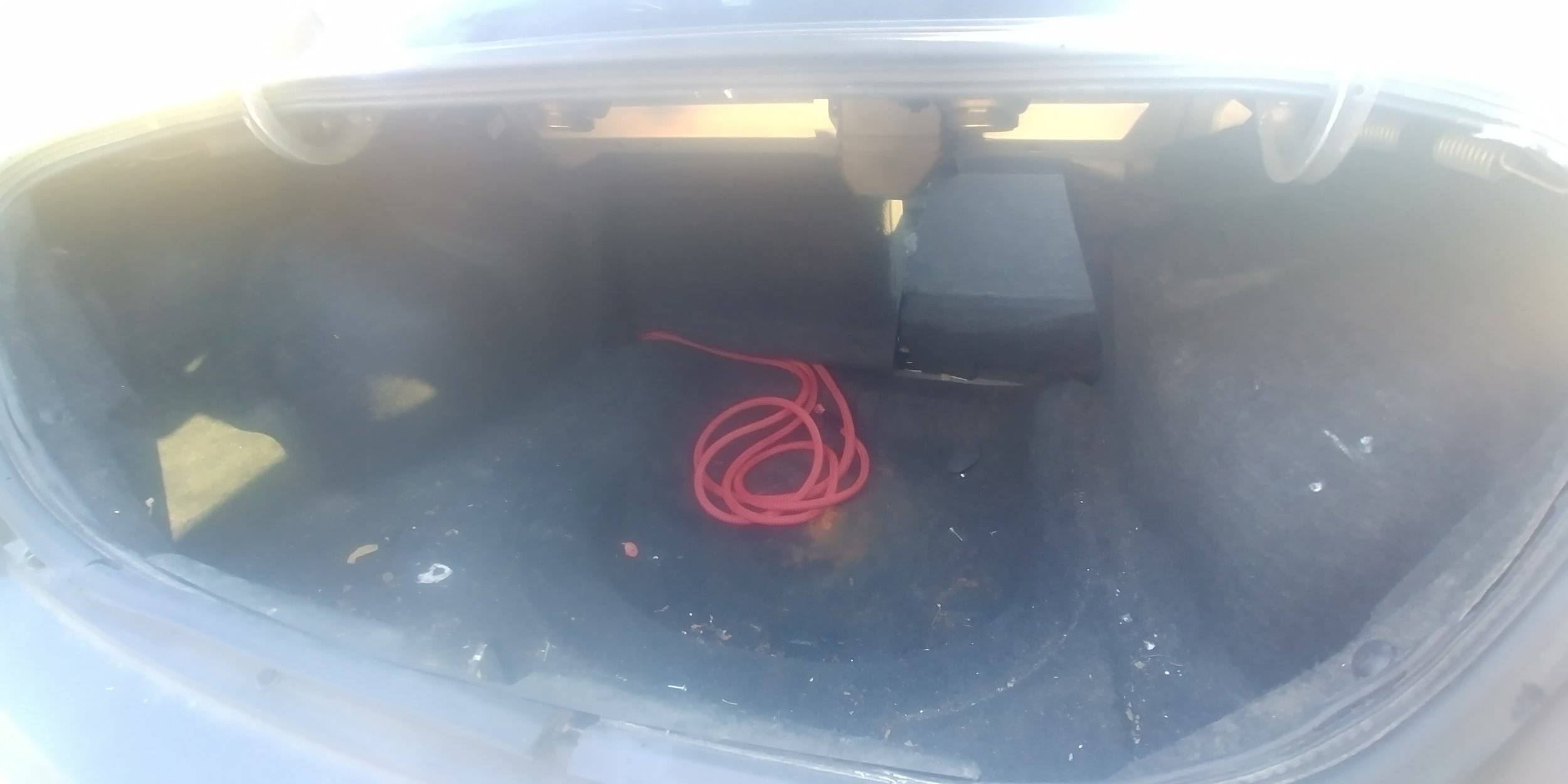

Just wondering about options on trunk build. Considering 1 15" Zcon in smallish trunk. About 5-6 cubes gross available. I know I'll be building in the trunk as trunk opening is not that big. Considering the Sundown SFB-3000D to power it.
Big question in my mind is if there would be any benefits to designing a box that port came up through rear deck. I've seen some say that porting through rear deck is the way to get the loudest for a trunk build.

when you do anything like a series tuned 6th or 4th order blow through the rear deck, you need to brace, deaden and seal off any kind of airhole that goes to the trunk to avoid cancellation. A 12 wont fit, only a 10 will fit especially if its a Zcon. 6th orders are huge. Definitely have someone design it for you. or you can just do a normal ported firing the rear trunk or a rear trunk wall.
If i did a standard ported box facing the rear of vehicle, i need there to be at least a foot of space between sub/port and the back wall of trunk, right? This was the main reason i was shying away from this as losing that foot significantly effects by box size potential.

no you just need 4 to 6 inches

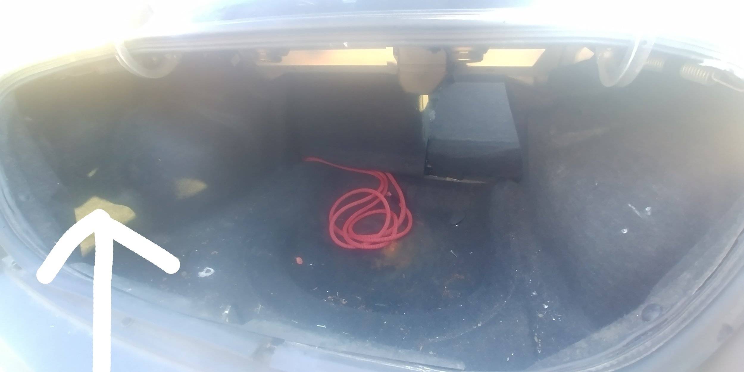

Ok, what do you think if i face speaker to the side/corner of the trunk? The wider section of trunk is there. You can see from pic that there is a little opening there. It would allow me to build the box all the way to the rear wall. Only thing is the port would likely be right up against the side wall of trunk if it fired sideways as well.

if you wall off your trunk then hell yes portyour box through the rear deck. i even recommend adding a vent of some kind even if its not walled. i've had several trunk builds and on cars where you can either remove or fold down the back seat. you notice a huge gain in output. so a car with a solid wall behind the seat you would want to vent the trunk into the cabin of the car to gain that lost output you should be getting if you want some examples or see some pics go checkout my posts. i did a build just like this and the post has lots of pics go check'em out https://www.caraudio.com/threads/sealed-enclosure-for-2-sa12-d4s.577015/post-8483187
