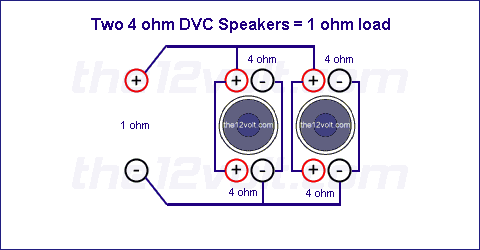

Yea thanks for the suggestions guys. Is the 1500 watts at 2 ohms peak or rms though? And how would I wire it so both subs could be hooked up to it? bridge it and run them in parallel or something?
RMS. You can't bridge a mono (1 channel) amp. Wire it like this...
BobbyDD would that only be using one voice coil on each? I'm not looking to get them right away, so I'm trying to just build my knowledge on everything so I know exactly what I'm up against once I buy them. Would that still give me the full potential out of them?
It's using both voice coils. It will still give you their full potential.
