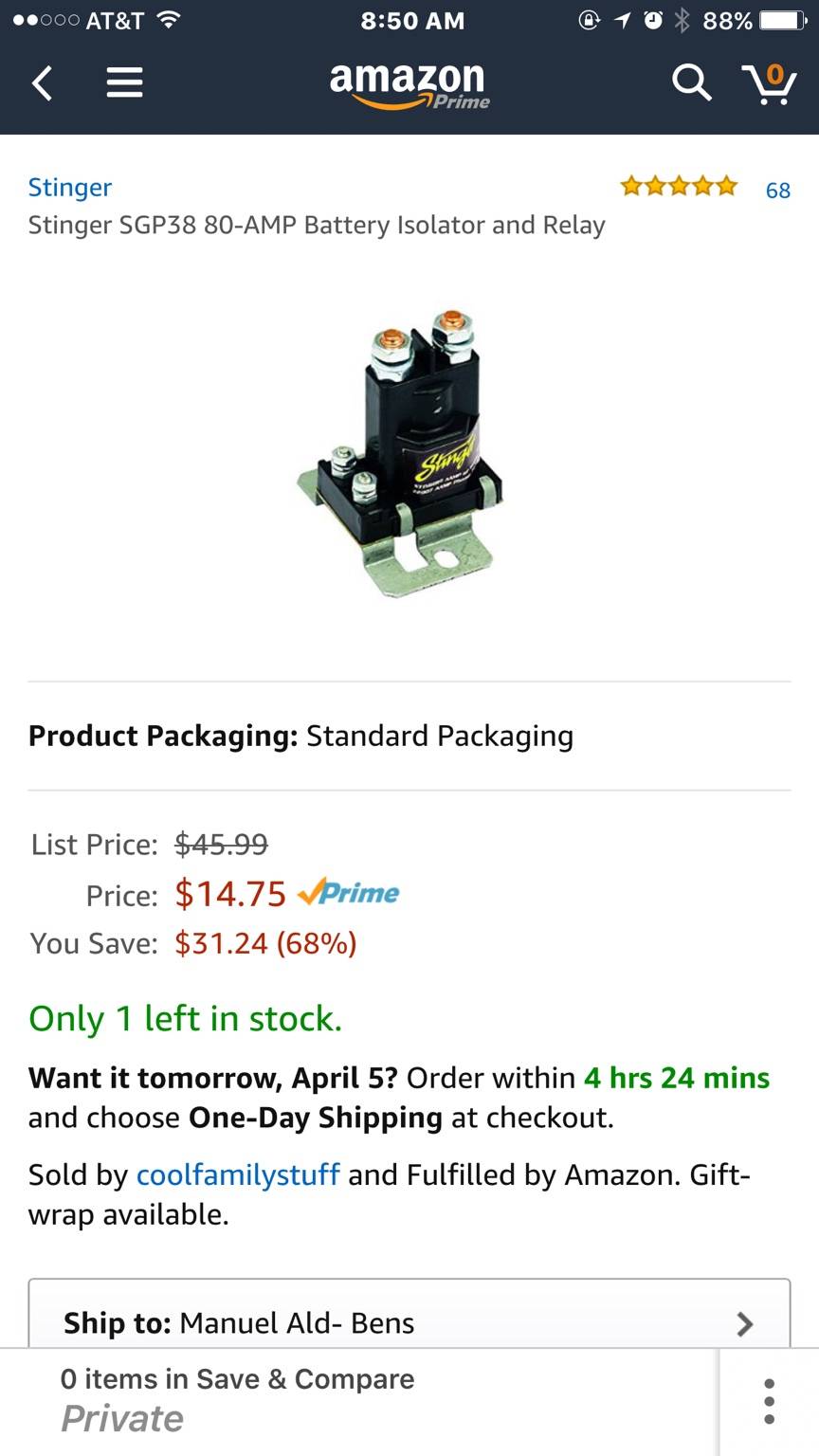

How necessary is an isolator when adding a second battery?
