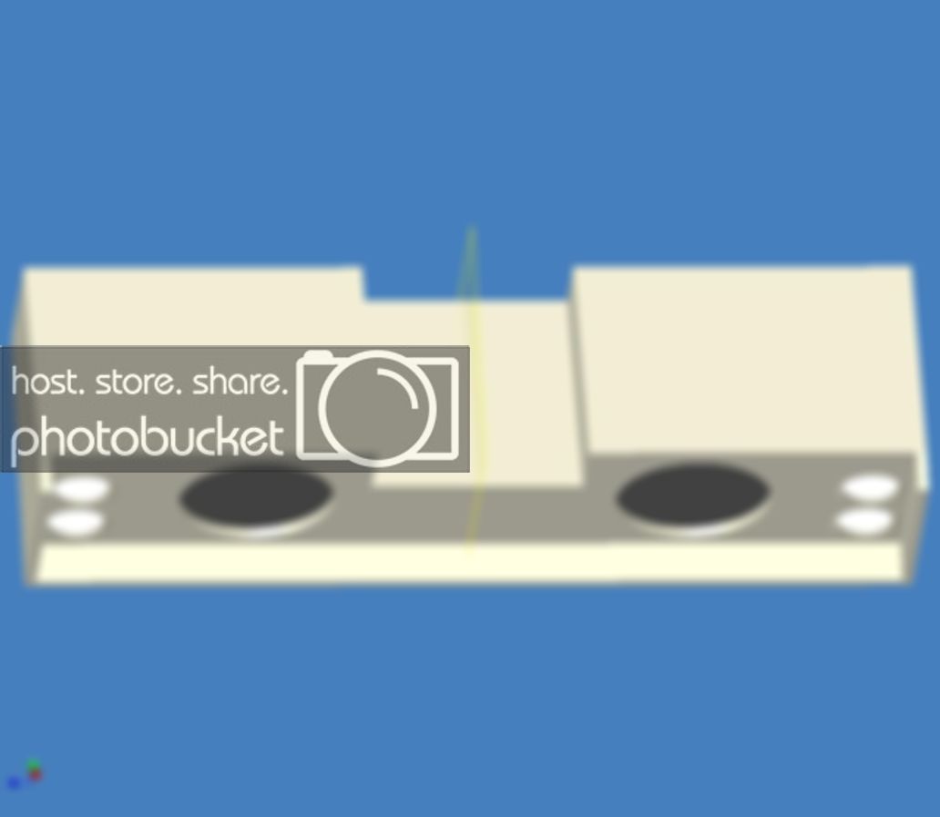

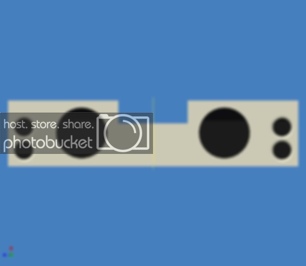

i am building a box tomorrow and it turns out i have the room to make it a ported box so i want to go that route.
the box will house 2 12" si BM's
there is no good area to place 2 ports next to each other so i am planning on seperateing the 2 subs and each chamber will have a 4" pvc port
does this sound like it would work?
i will have some pictures of what i am trying to do in a little while
Thanks,
~Magick_Man~

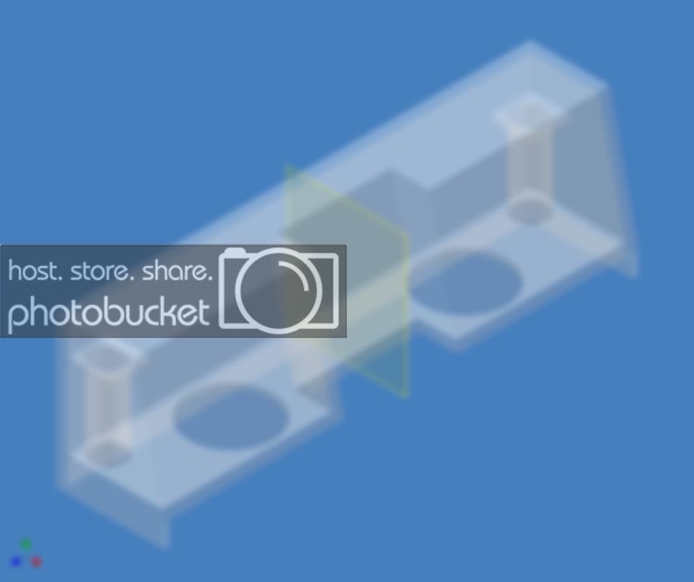

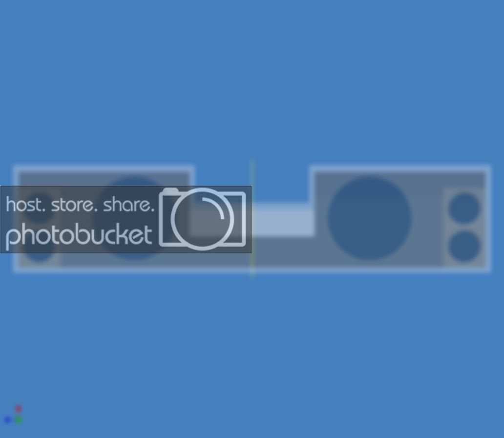

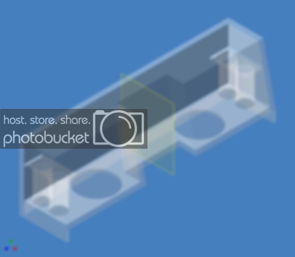

here is the basic idea i have right now.
it might change a bit but that is pretty much it.
so if i dont make 2 seperate chambers will the subs really utilize the area in the middle?
Thanks,
~Magick_Man~
you need double that port area.
have fun trying to make it fit //content.invisioncic.com/y282845/emoticons/frown.gif.a3531fa0534503350665a1e957861287.gif
//content.invisioncic.com/y282845/emoticons/crap.gif.7f4dd41e3e9b23fbd170a1ee6f65cecc.gif
i am using a port calculator and for 2 4" ports in a 2 cube box tuned to 34 it says they need to be 26.xx"
is that each?
if it is then that sucks.
because i can fit in up to 14" long ports.
would i be better off with 2 3" instead of 1 4" ?

um, what's the volume of the box (after displacement) and how long are the ports?
adding two ports like that (and keeping them the same length) is going to make the tuning A LOT higher (10hz +) possibly.
i dont have the exact number yet but i have about 2.2ish per driver after the port is taken out.
i was looking at a single 4" at 11.xx" long which would supposedly give me 34hz with a 2cube box
now i am looking at 2 10.12" long with 2cubes after displacement which should give me ~36hz
i will end up with as close to 2.0 per chamber after the port and sub is taken out.
~Magick_Man~
yeah, thats probably not going to work... the port calc is EACH port, so adding more is just making your problem worse
yeah i figured that.
i was using one at 11.xx long shooting for 34hz
now i am using 2 at 10.12 (i think) shooting for 36hz
~Magick_Man~
so i guess the real question is will 2 4" ports 10.14" long in a box 2.0 cubes after displacement give me a 36hz tuning?
i am judging this off the port calculator from carstereo.com
