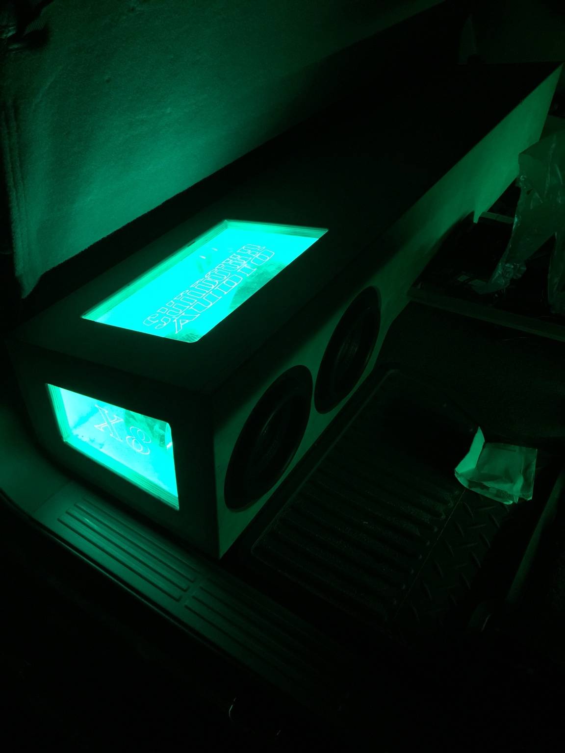

Sundown x8's on a twisted sounds 1.8kw 2.13 cu box tuned to 33hz
Sounds great and shakes the cab good
