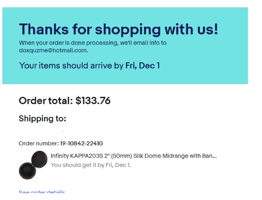

I just love the ability to effectively cover that 500-3500 Hz band with a driver that does not require that i cut an extra hole in the door metal. Almost seems like the dome mid was designed for car 3-way use in a car. While a like a small-sh cone driver, can't argue the effective use and ease of installations these drivers provide - especially with an active DSP system, seems like the best way to upgrade my 2-way system. I'm going to get them, put the rear fill t-ways on passives, move the FDP-4.600 to power the front 6.5" and the rear 6.5" two way with passives, run the AC 4.300 to the (new) front mid/tweeter configuration. OI really like these Pioneer dual layer Twaron fiber 6.5s and the aluminum tweeters are very nice too. That gives me 150 watts to the 4ohm 6.5's, about 65 watts to the mids and 50 watts to the tweeters. Thinking that x-over points will be 500/3500. With the DM 810's option for 12/24 db Linkwitz-Riley x-overs, should bea nice setup!

Nice, I will have to play with the high end, might bump that 3.5khz to around 4.5, 5khz depending on the characteristics of the dome, we'll see. The infinity mid is efficient, 94db efficient. I'm not concerned about that 65 watts, pretty sure I'll be turning the mid gains down!
So dope! The guy dropped it another $14, like a typical addict, I jumped at the fix!!!
To Infinity and beyond!!!

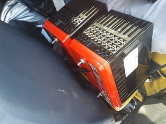

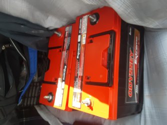

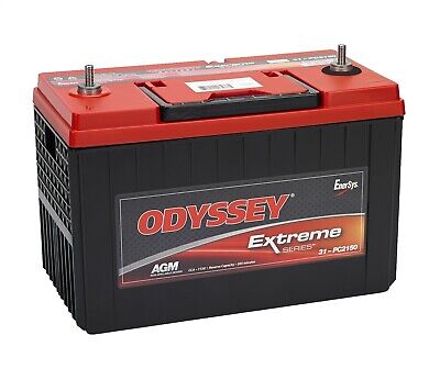

I like when they send a lower offer..LOL 😂 😂 😂. Im same way. Ill jump on it of Im not careful... I snagged 4) of these from a Data Tech last Saturday for $700 bucks to use in my next build. Apparently they ordered 7 too many. The lowest was resting at 12.7v. I need get them inside actually.I forgot about them being in the back seat of my truck👀👀:poop:! Hard to pass them up.
I didnt read on how heavy these jokers were. Hopefully they will serve well. Its been a few years since Ive used Odyssey.. like 7 years maybe?
