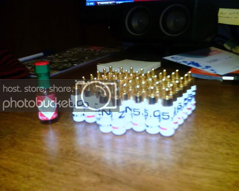

Finished the RCAs today. 13'. Its funny how a whole 100' of spool almost is disappeared now. I used 78' of wire out of my spool.Used a lot of terminals too...half of those are gone now, i made some cables for some other guy too. I ran out of black heatshrink so i had to cut into my red stash
I'm hoping my whine is gone now.
