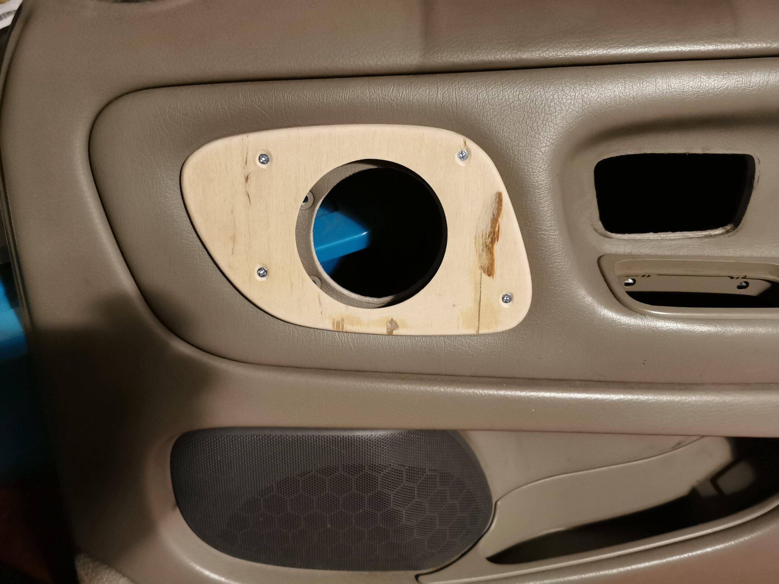

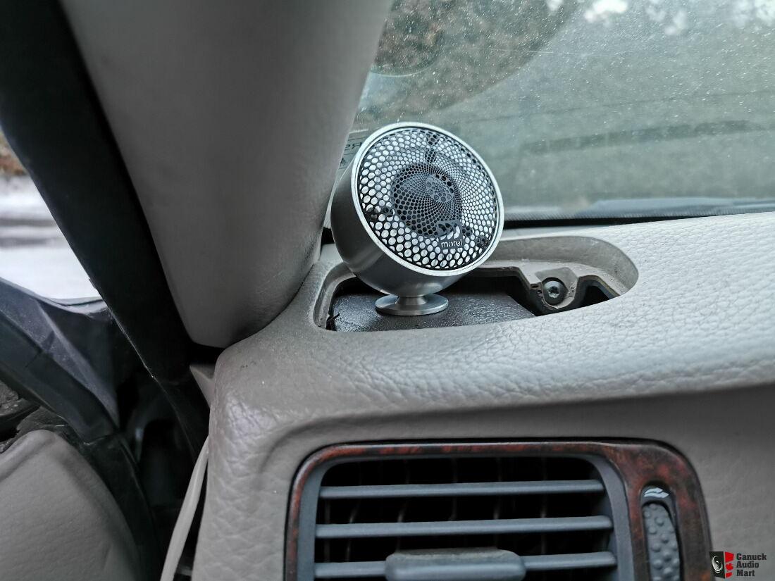

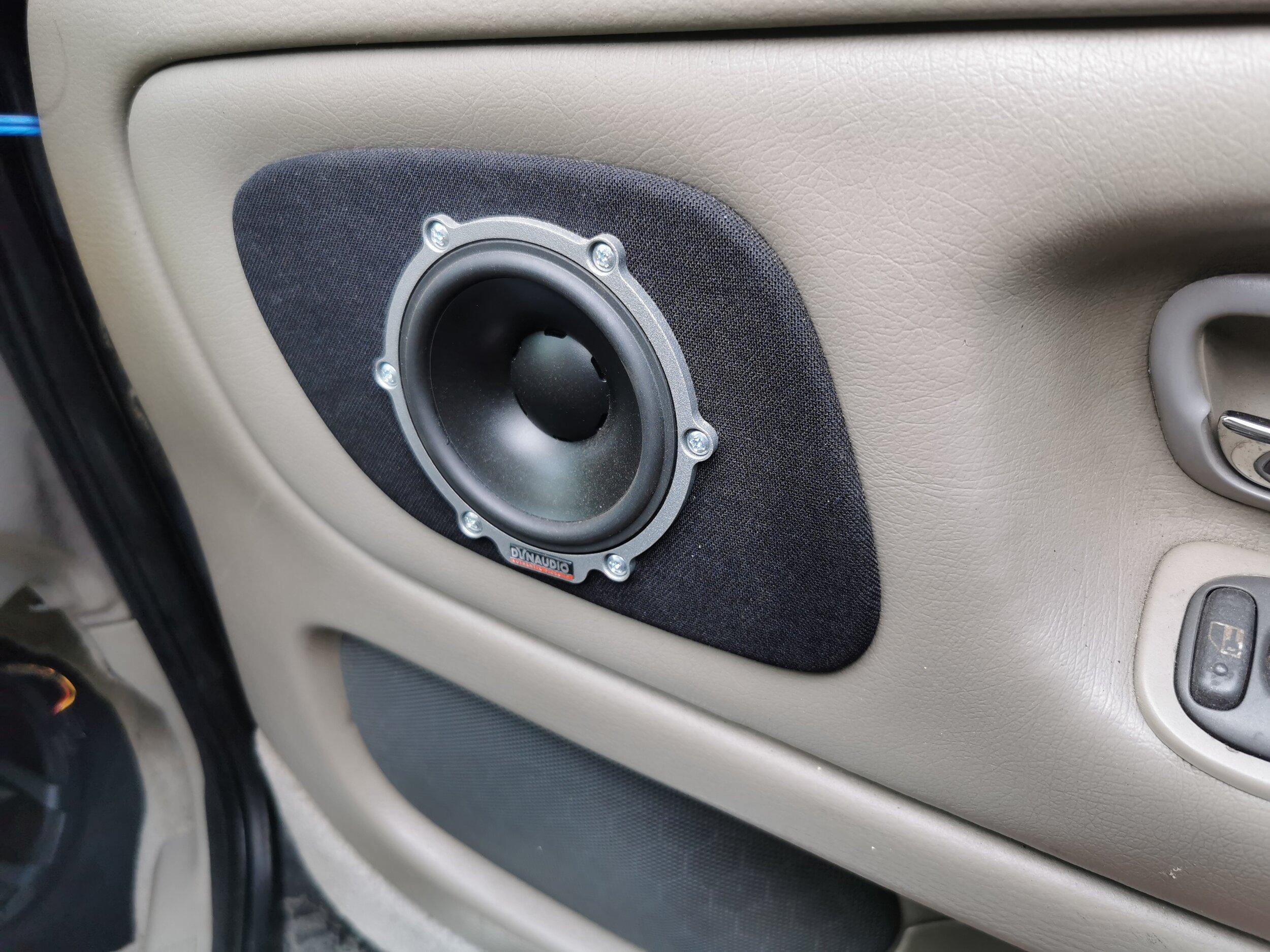

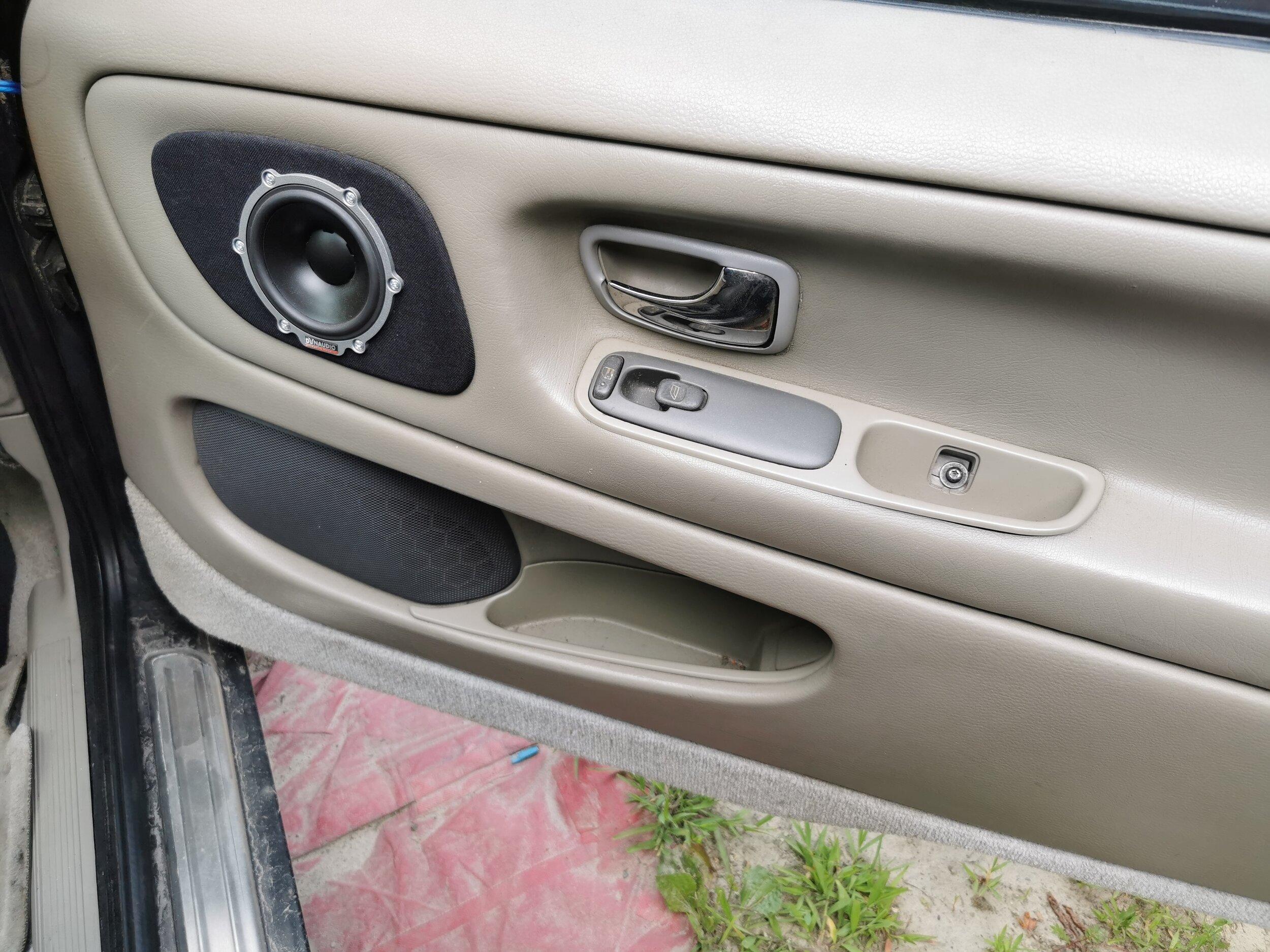

The plan was tweets and mids in the A-pillars but I was tired of having no music so I put them in the stock locations for what I though would be temporary but never completed the pillars mod. The magnets of the 430s are too wide to fit them in the stock dome mids locations so I surface mounted them.
I used black speaker grill cloth as finishing.

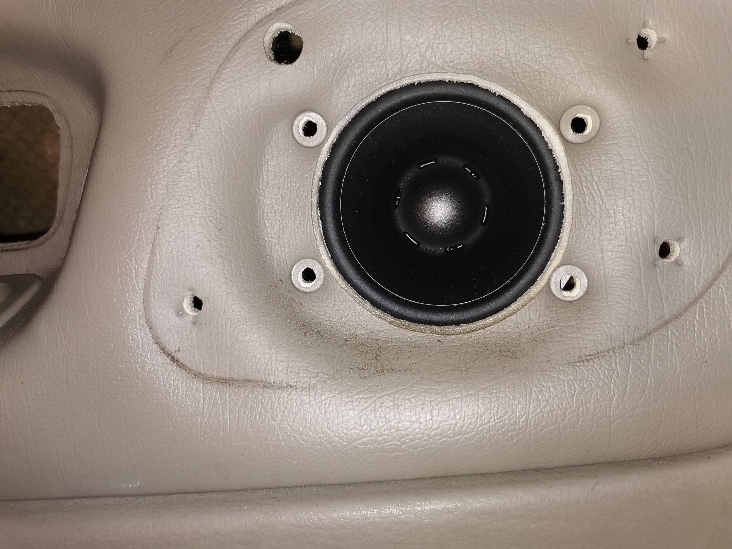

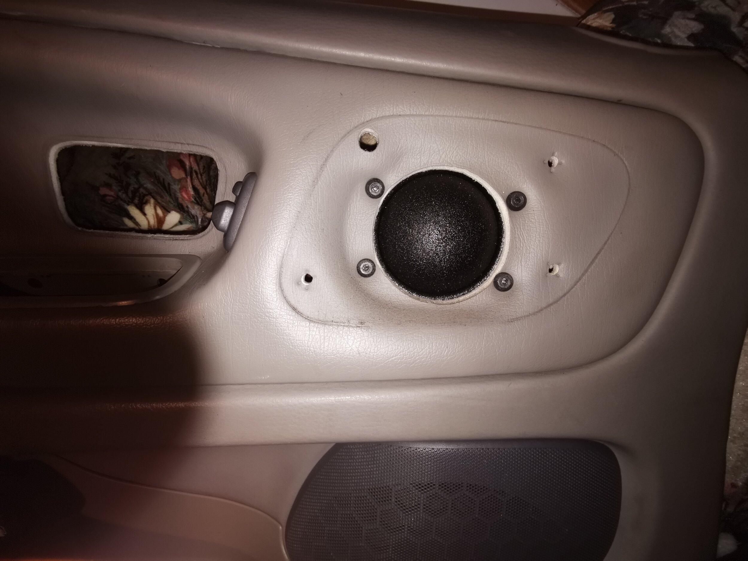

Tweeters also went in stock locations but with aluminum pods.

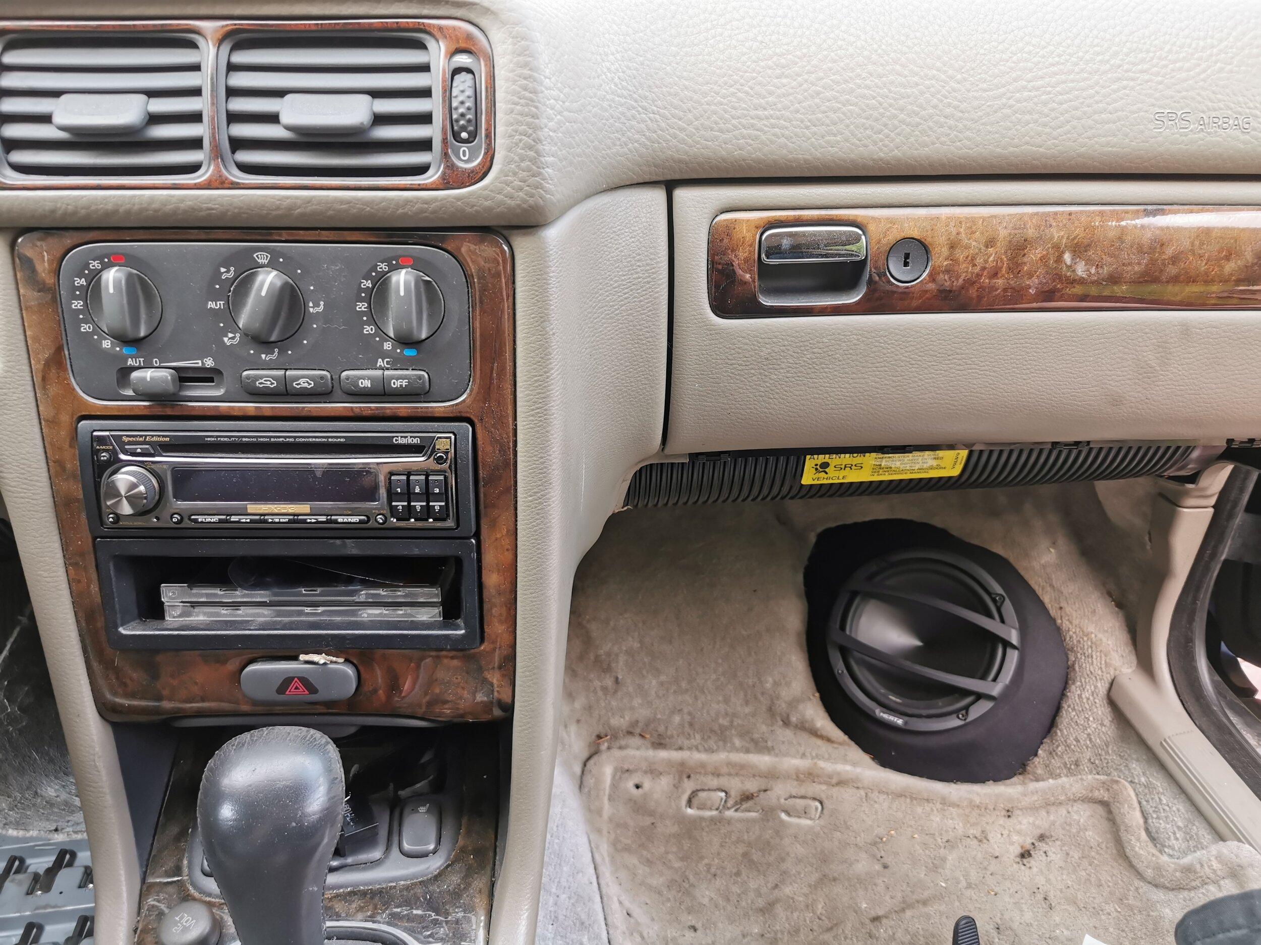

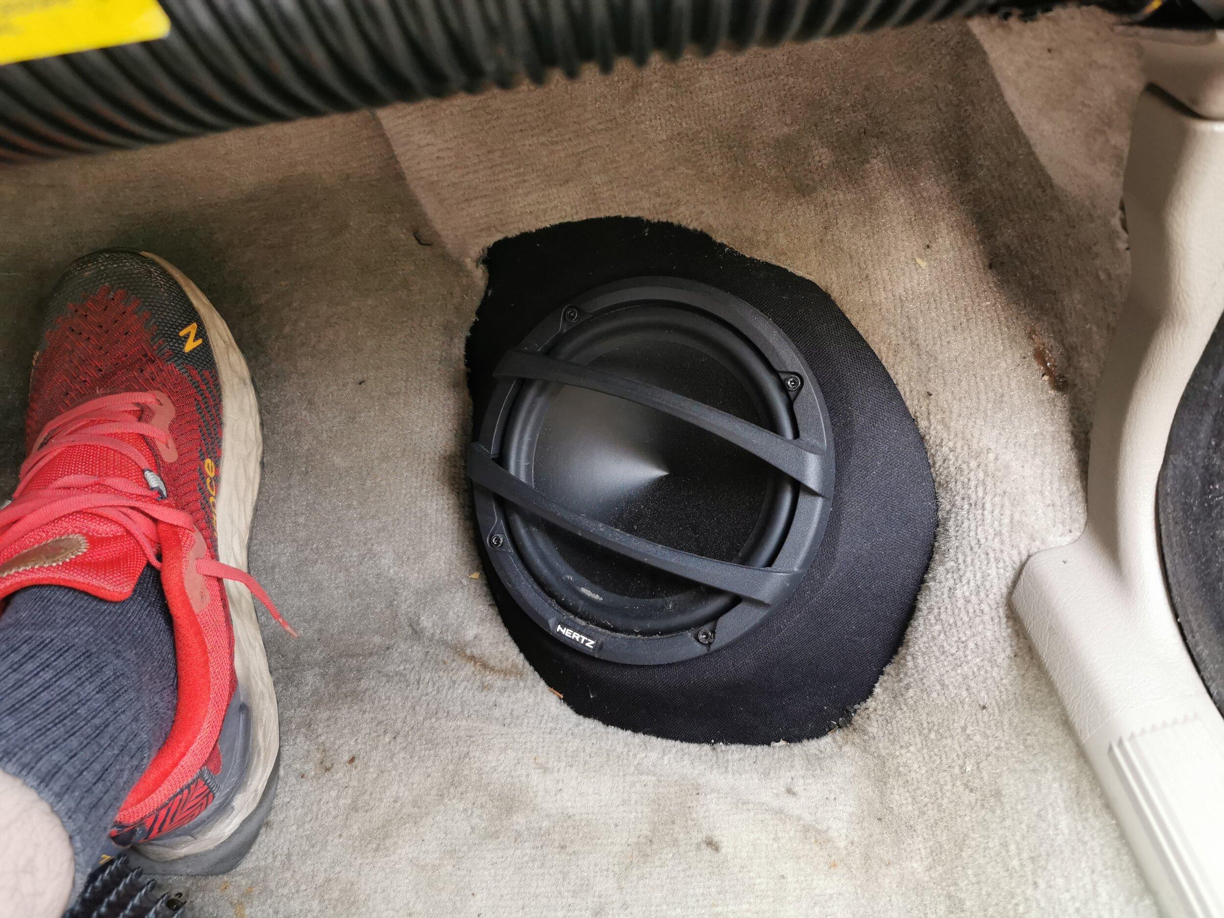

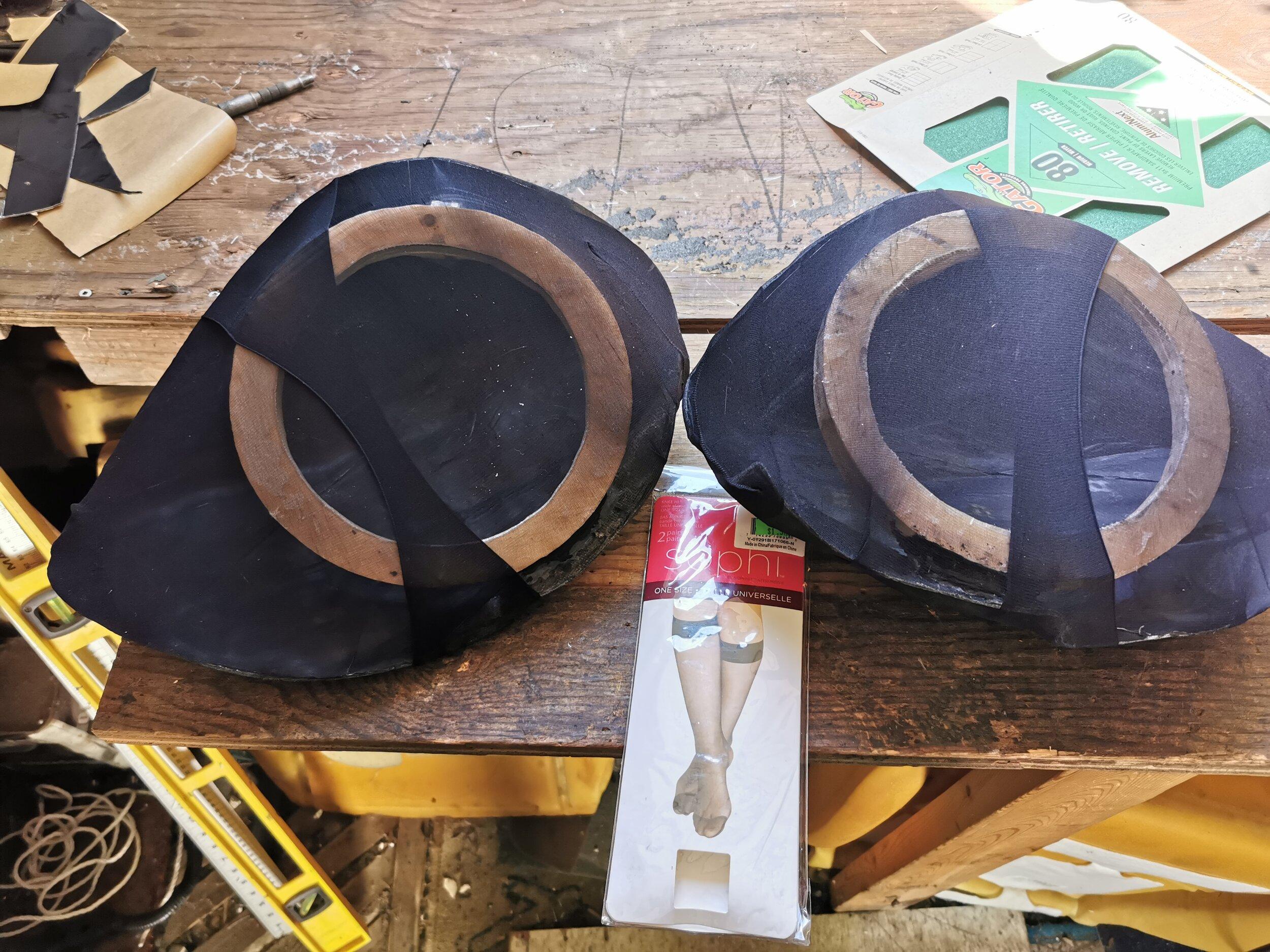

I don't have many (or can't find) pictures of making the kick pods but can't stress enough how manly it feels to go in a dollar store to buy stockings.
Here's the result also finished with speaker cloth. Remember, I was supposed to eventually get a black interior.

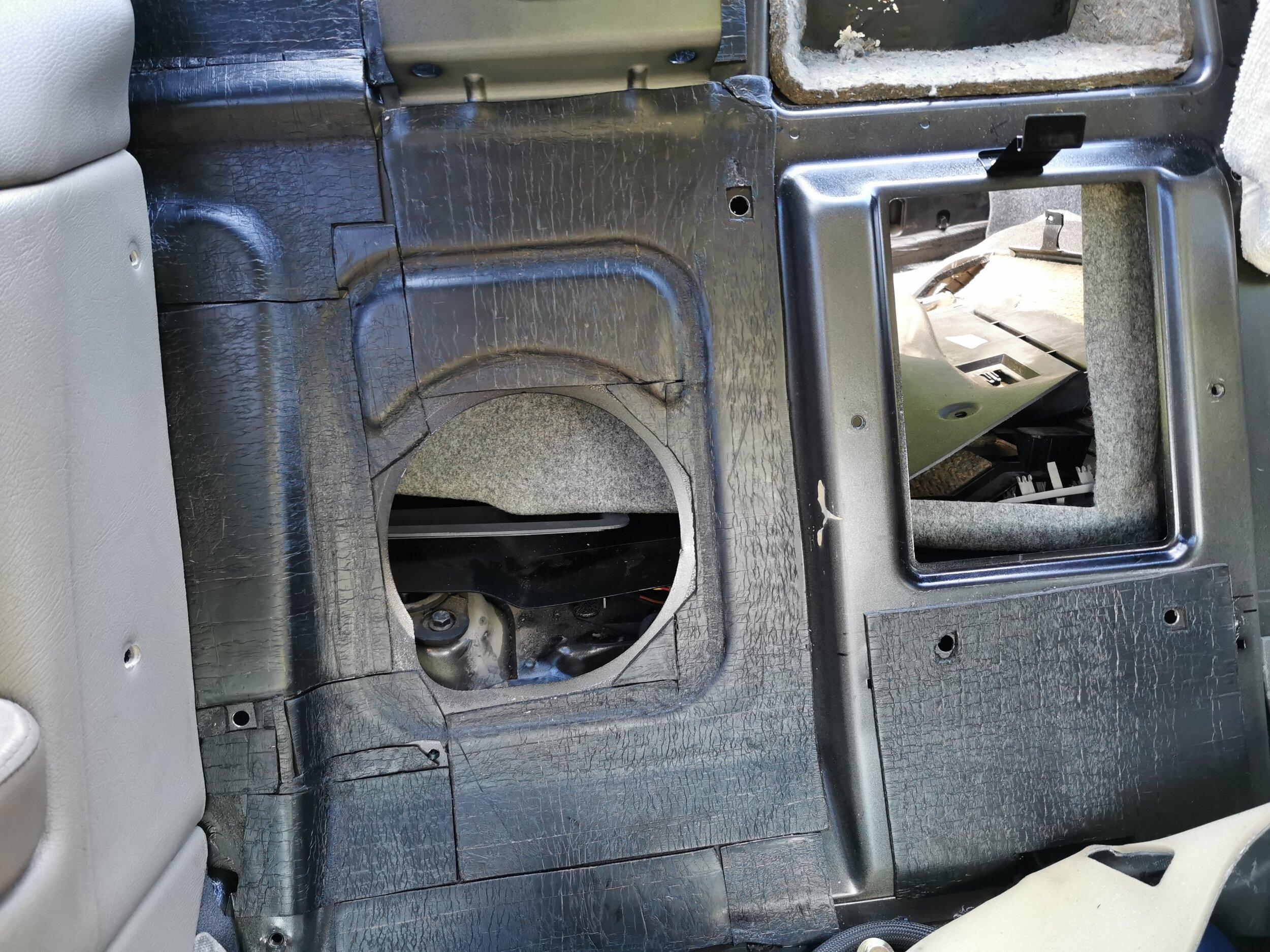

Not much sound proofing was made. I just wanted music asap and planned to do it later. Glad I didn't now. I want to keep the car as light as possible. I only did the rear seat panel and the upper deck with damplifier over vibraflex. I'll keep that since it makes the ride feel stiffer.

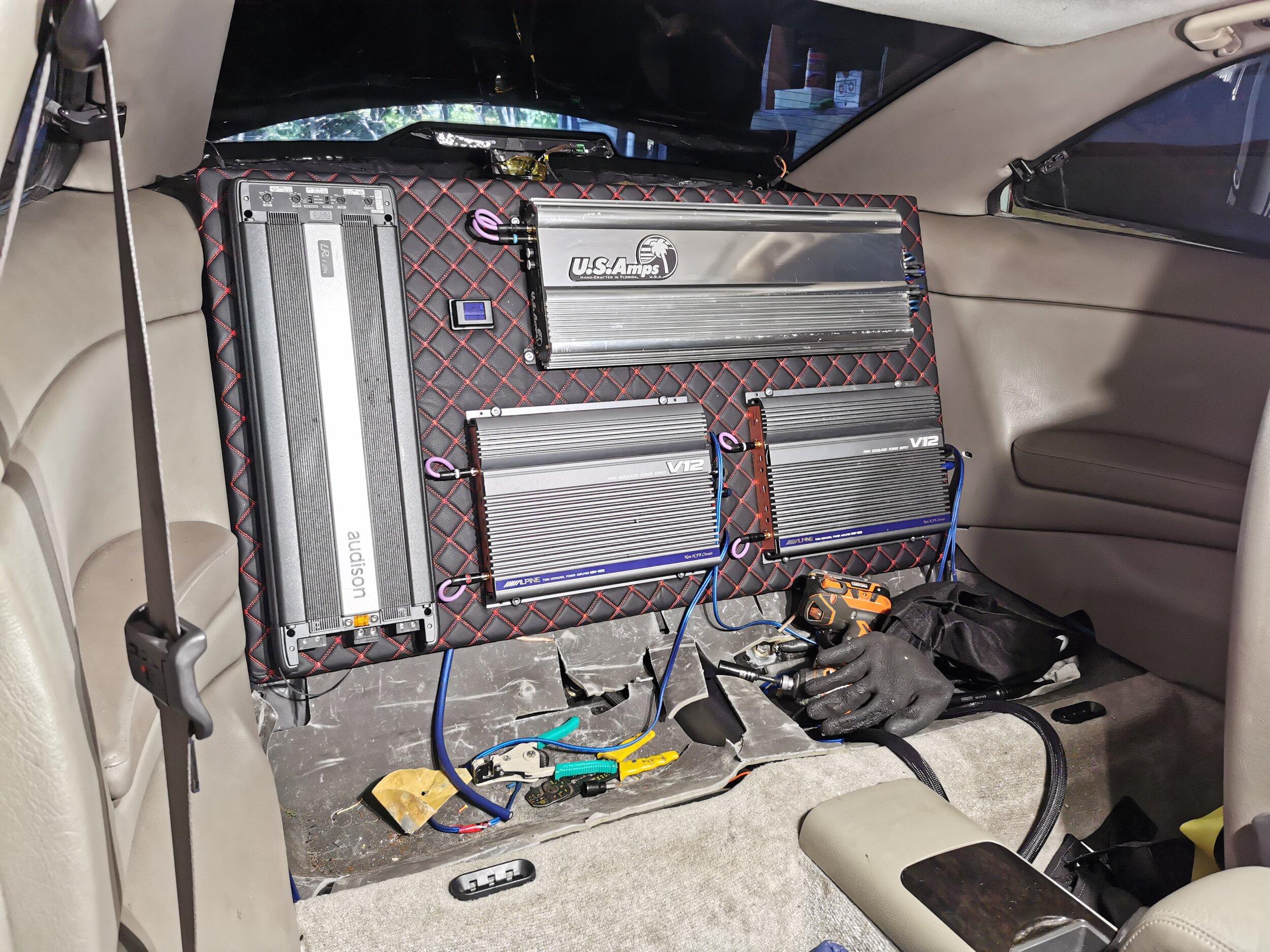

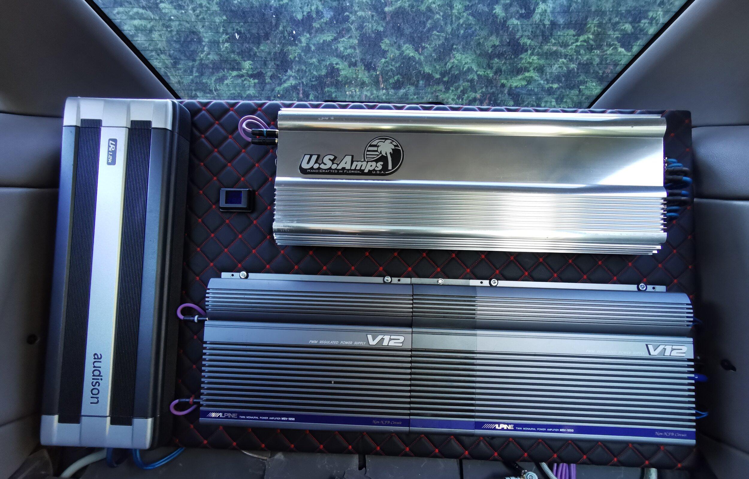

Now, time for the amps to go in.
