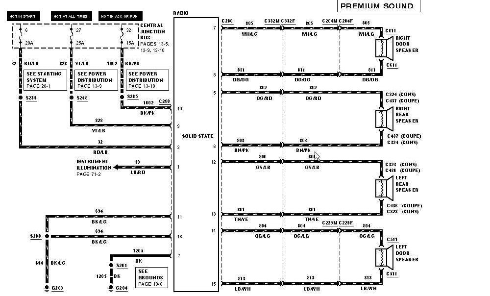

I'm not planning on ripping the whole thing out, as I think the system is decent as is. I just need some subs in the trunk. I was thinking 1-2 12's.
This is the schematics BTW. I have no ****ing idea what they mean though.

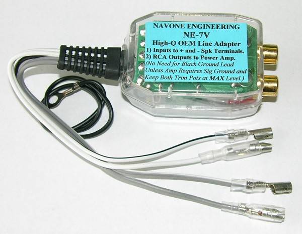

The mach system won't be hard to add a sub onto. Just add a line out converter to the rear speakers, and roll from there. No headache like you would run into with something like a new radio.
Check out http://www.davidnavone.com and go to the "Adapters" section. Look at the NE-7V line out converter. Basically, all you do is splice the inputs from the Line Out Converter (LOC for future reference) into the speaker wires from the back speakers. Then, run an RCA from the LOC to the amplifier. That's all the integration you'll have to do from the stock system. Then, just run power, ground, and remote turn-on to the amplifier. A switched 12v source can often be found in the ignition harness, the fuse box, and sometimes power outlets.
Here's a diagram for the LOC.
