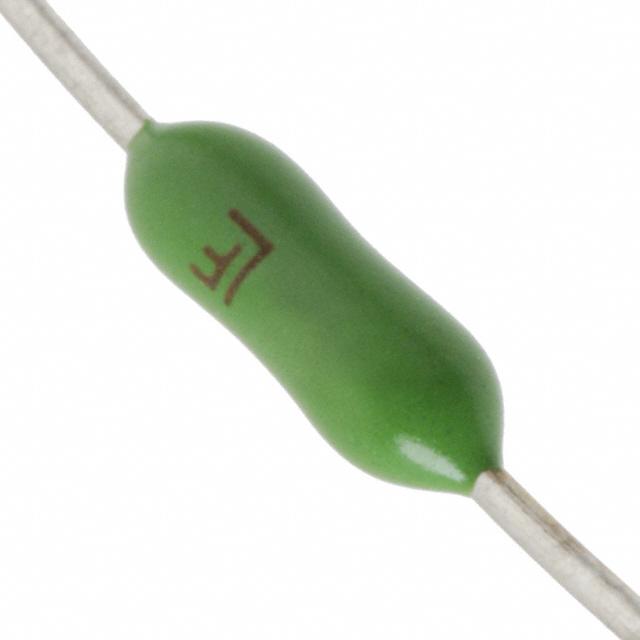

If the remote wire grounded out, it can damage your head unit. You might have blown a pico fuse inside of the head unit killing output on the REM wire.

If the remote wire grounded out, it will fry your head unit. The head unit supplies the voltage. You might have blown a pico fuse inside of the head unit killing power to the REM wire.
