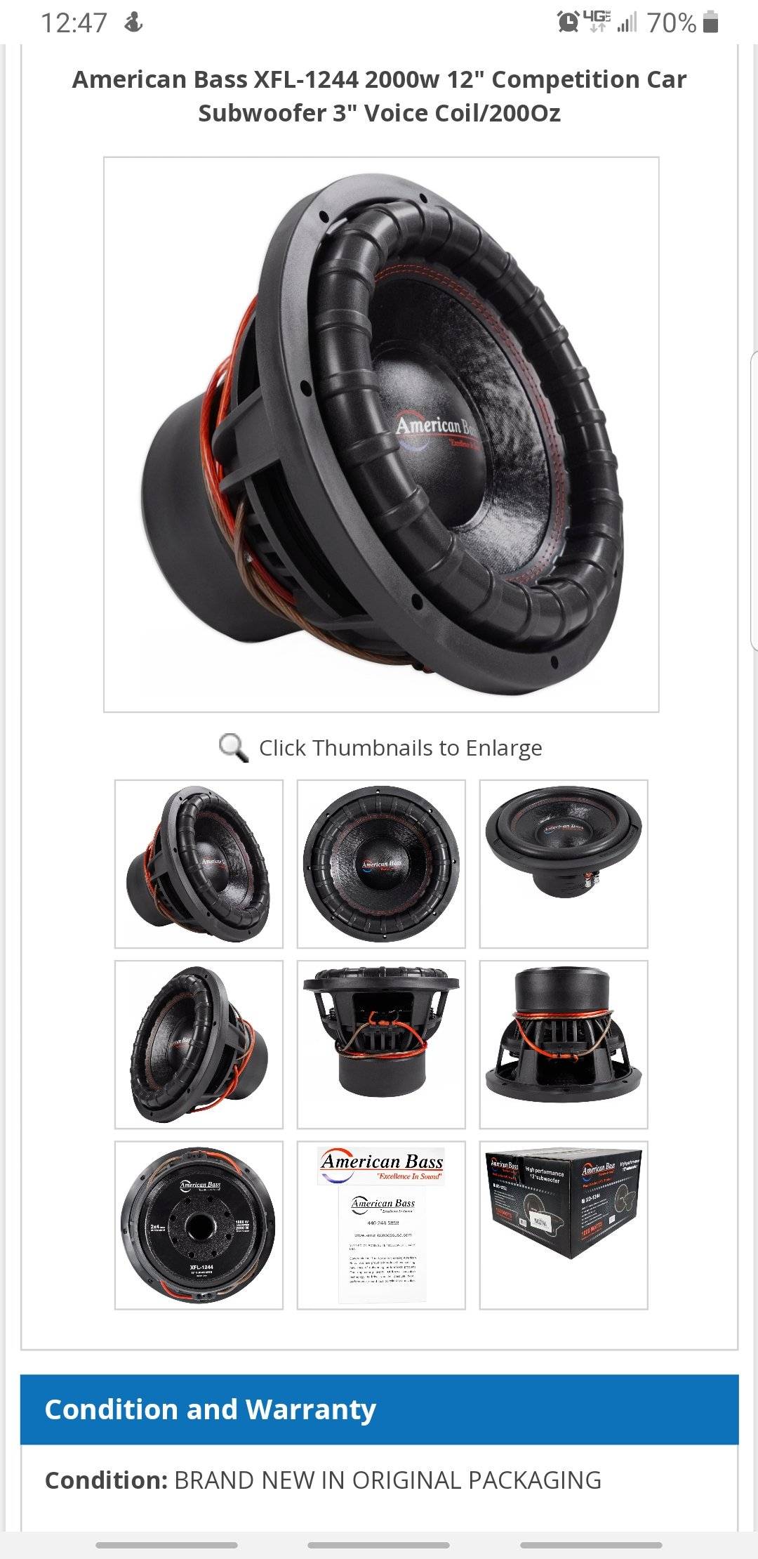

Get two of these wired to one ohm on your amp. You will be happy.

One of those XFL's wired one ohm will be an upgrade, and, two would be even better. As long as he has the air space for them, get two. Plus, he already has a free box lined up. He said he wanted an upgrade, and, this would be an upgrade. I understand trying the box first. As long as the subs are still in good shape. However, if the box doesn't help, then you will then have to get another new box and subs.

Get two of these wired to one ohm on your amp. You will be happy. View attachment 18792

D3's are very capable woofers. I have seen them in setups doing mid 140s. 2 D3s would destroy a single XFL.
A single XFL is a downgrade over the D3s.
You need cone area if you want to move air. 2 lower powered decent subs will almost always be louder than a single higher powered sub of the same size.

Not what I said. Get one or two of the XFL's, as space permits, and wire them/it to one ohm in the new ported box. One sub and box should cost about $225. Two subs and box would cost about $400. Remember, those subs are six years old as well. Try a new box first, by all means, save the money if possible. If that doesn't work, try the XFL's. That amp should be fine at one ohm. One XFL1222 or Two XFL1244. Sounds like one is about all that will comfortably fit. Not looking to get ridiculed because I suggested possible options. ✌
