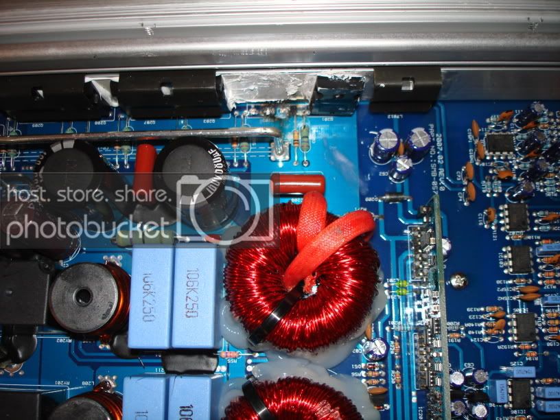

//content.invisioncic.com/y282845/emoticons/crap.gif.7f4dd41e3e9b23fbd170a1ee6f65cecc.gif I'm hoping since I can see burns on one fet only 1 of them got messed.
Ah okay, I just didn't wanna break it. Also, are all the tranistors that size the same type? The one that actually blew is in a very awkward spot and it's hard to get my hands up under the clip. Would be easier if I could pry off another one
There's no guarantee that it will be the same. Use a screw driver or something.

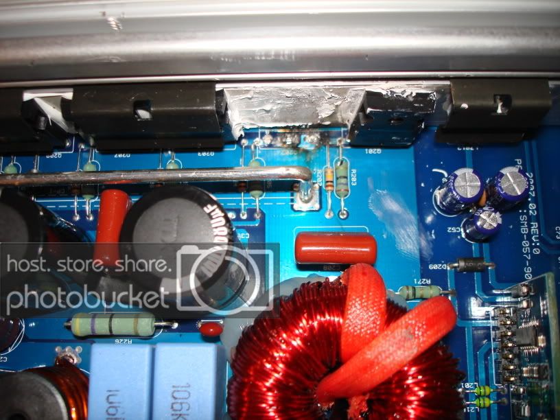

What else is there really besides reapplying thermal compounds and changing the fet(s)? I suppose I should check the board and make sure everything around the burnt fet still has continuity...
after some inspection, looks like I need to remove the side rails to get these clips off? lol, even with a screw driver they don't budge, and there really is no space for them too. I see there are some allen key screws on the sides which seem to hold in a rail though, I'm trying to remove it now.

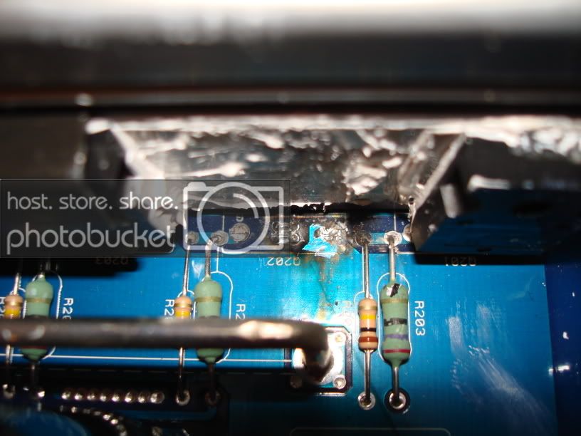

Well it was no easy task guys, but finally I managed to get that clip off. I'm not sure how those things go in there, but boy are they hard to remove. Anyways, it turns out the fet was not even soldered onto the board anymore. This could very well be the problem I think... Haha.
Also, where the legs were are where the burns originate from. Pics up in a few. I don't see any numbers on this fet though. //content.invisioncic.com/y282845/emoticons/sneaky.gif.7189749b3a3f769e8815b47e8ae87f88.gif
