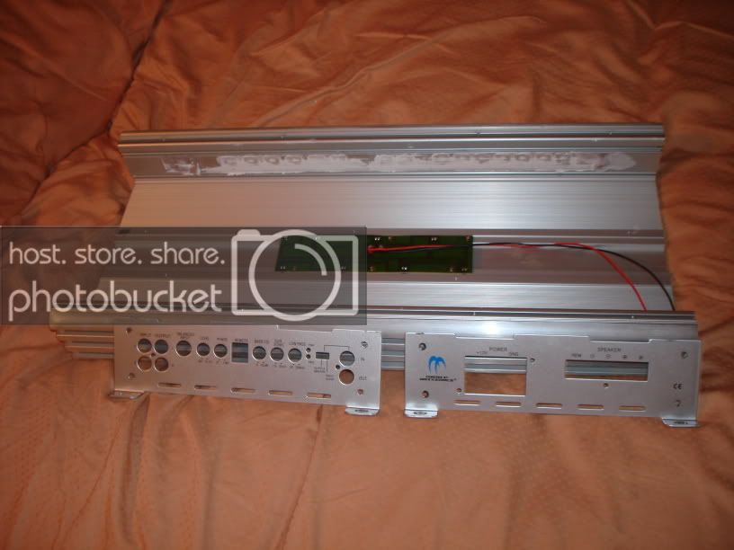

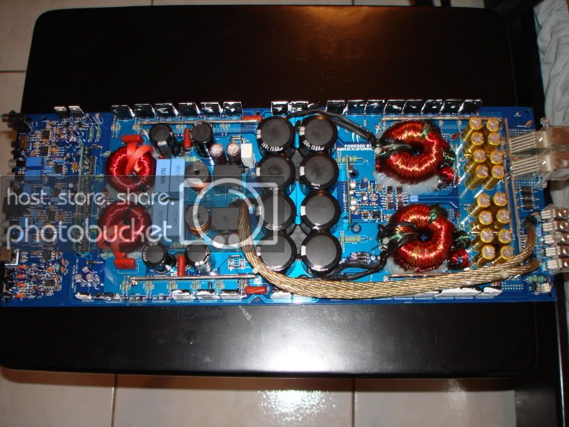

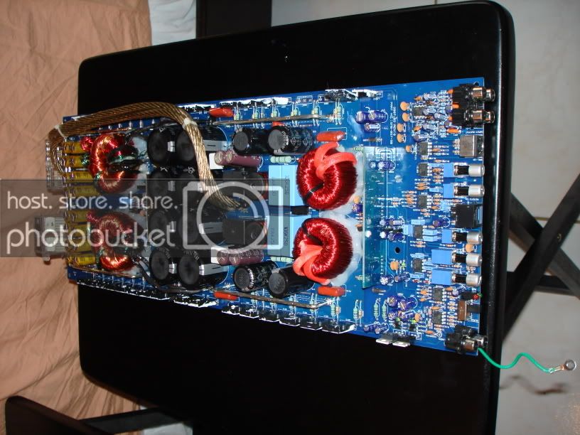

Here's some pics to tie you over.
LMK if you want pics of any specific parts or the under belly of the beast //content.invisioncic.com/y282845/emoticons/smile.gif.1ebc41e1811405b213edfc4622c41e27.gif

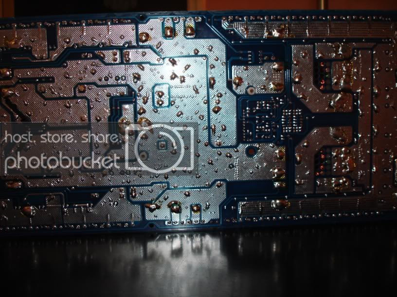

Here's one of the bottom just because //content.invisioncic.com/y282845/emoticons/tongue.gif.6130eb82179565f6db8d26d6001dcd24.gif

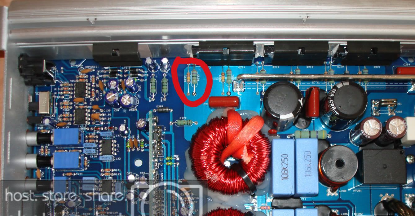

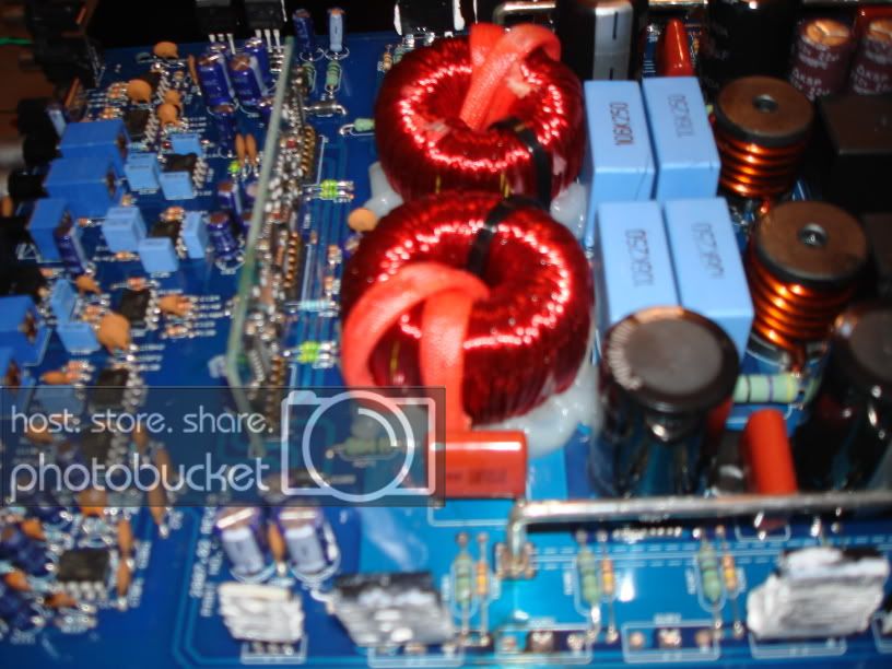

Now the question is, are the smaller ones 100kohm as indicated by the color bands, or 55ohm as indicated by my multimeter? //content.invisioncic.com/y282845/emoticons/tongue.gif.6130eb82179565f6db8d26d6001dcd24.gif
As seen there, smaller resistor is the one in question here. Color bands are Brown, Black, Yellow, Silver. Now, from what I was taught, that comes out to 100kohms with a 10% tolerance.. Butm, my DMM thinks otherwise?
Also, I'm guessing they are metal film resistors, should I assume otherwise?

Well on a serious note, I found out the resistors are flameproof 1 W resistors that I need to replace for the gate resistor. Thank you Jacob / Chris, you were both a big help on that one //content.invisioncic.com/y282845/emoticons/smile.gif.1ebc41e1811405b213edfc4622c41e27.gif
