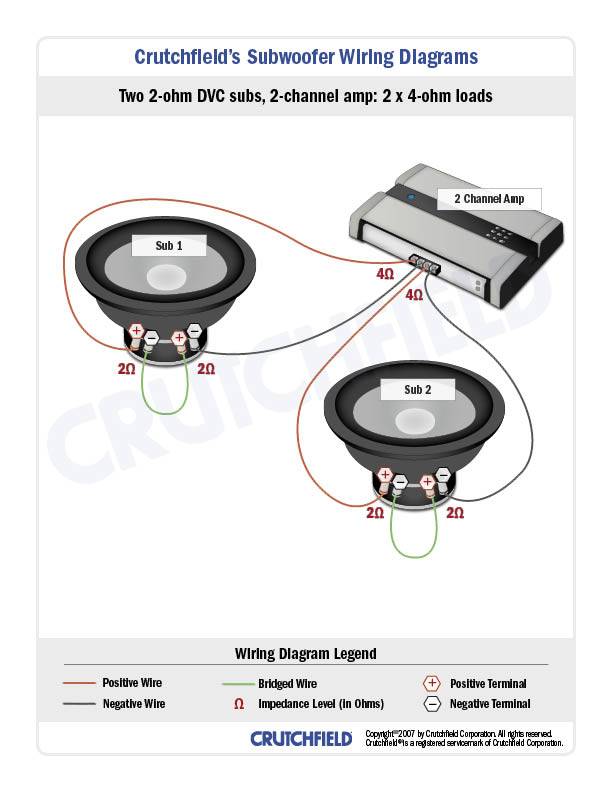

I need help with wiring my subs
this what your asking?
yea but do i twist both negatives and both positives together from both terminals and put them to the amp. i only have a one channel mono amp.
