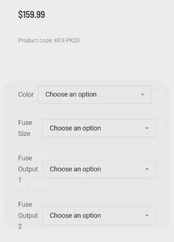

Going to buy a amp kit from knuknkcept but they're asking which fuse do I want to use
Which are 150 200 250 300.
I'm not sure which fuse rating I'm suppose to use.

That amp will probably pull well over 300 amps once you consider efficiency
At full power, you will be drawing about 450 amps. However, I doubt you will be pushing your system that hard. So, that being said, I would use at least a 400 amp fuse. Remember, the fuse is not to protect the amps, it's to protect the wire from burning up.
